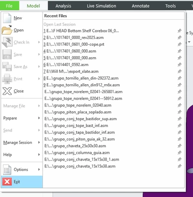

I cant save my part.
I am trying to add onto a part which opened up from an assembly. I make the thing I was trying to make but the save buttons are all greyed out. Not sure how to fix this any help would be appreciated.
The model also had a validation import failure, but I just clicked ignore. Idk if that's the cause but it still won't let me save. Thanks!

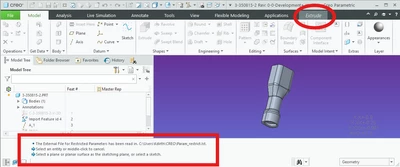

You don't show enough to diagnose the issue.  What are the latest messages at the bottom of the screen?  What tabs are open at the top?  The more infor you can give, the better we can respond.
My first thought is that you have a process started and still waiting on you to complete.  In the above image, the extrude tab is active and the last message is asking me to do something.  At this point most of the file operations in the menu are grayed out.

Hi
from your screenshot, we can see Check-in (above Save) which means you are in a Windchill environment.
There are some situations where saving is not permitted indeed.
What message exactly did you have on opening ?

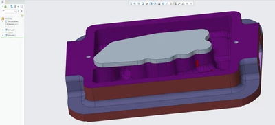

I've not seen this yellow icon before (SOLID48).  This does appear to be an import from perhaps an Autodesk Inventor file.  If it's trying to save back to an Inventor file, that may not be allowed.
