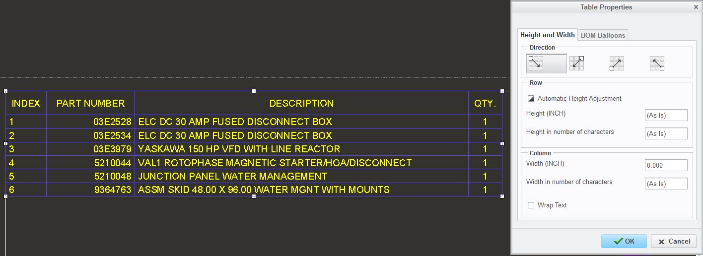

This is a 2D repeat region. As you can see my index is left, my part number is right, my description is left, and my qty is center. I may have described a little wrong, you only need to choose one cell in the column to change the text style in the whole column. But it is working for me. I am on Creo 3.0 M030 if that makes a difference.

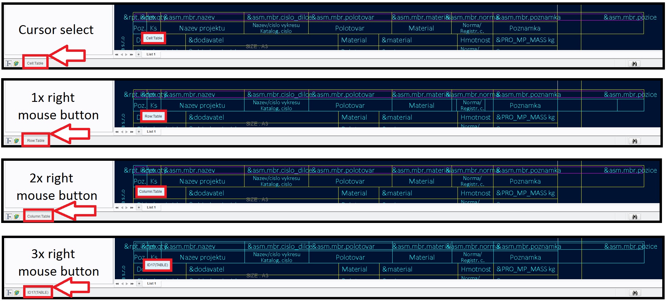

depends on what kind of table are you using.
     A) Do you define BOM table in format file?  ( *.frm )
     B) Do you define drawing table, that will be using thrue FROM FILE table
The location where you find "source table" can be different, but the princips that it works is everywhere the same.
After you select what you want (row, column or entire tabel) press and hold right mouse button.
Pop up menu will appears.
Select TEXT STYLE and define als you wish.
Hope it can helps
Regards
Milan Bonka
