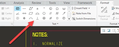

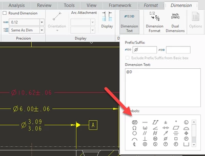

For a dimension, the symbols are in the DIMENSION TEXT selection.
For a note, the symbols are in the ribbon, make sure the format tab is selected

My process for note editing. I select the note (symbol box would be grey), then select within the note where I want to edit (or in your case, where you would want to add the symbol, the symbol box is now active/available).
If I'm making a new note, the symbol box is active immediately.
For an existing note, once your done, you can RMB properties and the old pop up dialog returns and you can edit in that window with the text symbol button available there but in my opinion the ribbon makes it easier (once you figure out the process)
