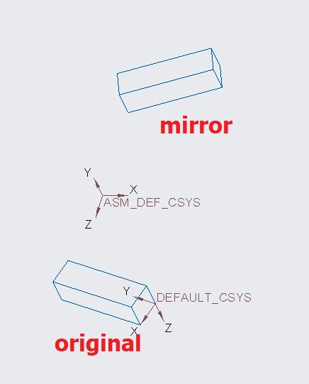

I have a question while using the Creting Mirrored Assemblies feature.
This is a mirror copy of the entire assembly.
There is no need to separately set the reference side for mirroring, just press Save a Mirror Assembly. What side do you mirror copy to?
Also, is there any way to manually set the mirror reference plane???

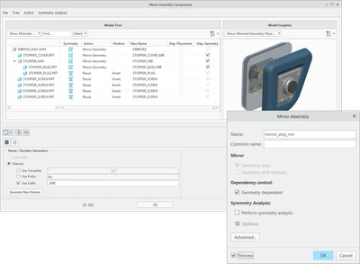

@Inho-_- wrote:
Thank you for your reply.
So, is it possible to change the base?
I am afraid that Mirror Assembly command does not enable user to select mirror plane.
Solution:
  • create new empty assembly
  • create mirror plane
  • assemble your assembly
  • use Mirror Component command
May 21, 2023 10:46 AM UTC
assembly is mirrored about XY plane of default ASM_DEF_CSYS coordinate system. See picture.
Inho_14-AlexandriteAuthor
May 22, 2023 1:31 AM UTC
May 22, 2023 6:04 AM UTC
Solution:
