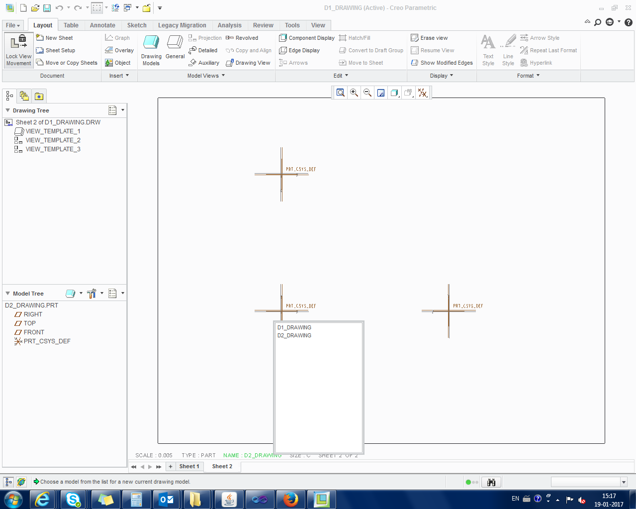

Hi
I am able to merge two drawing file but facing issue with replace solid model.
I have to replace solid model of added drawing.
I want to set Root Model to Each Drawing Sheet.
Please find below code.

The difficulty here is when the documentation of ProDrawingMerge says the handle to the second drawing is lost, what it means is:  If you have two drawings in session, D1 and D2, and you call ProDrawingMerge(D1, D2), then afterwards you have one drawing in session, called D1, which has the original D1 plus the sheets from D2.  The D2 drawing in memory is destroyed and all its data merged into D1.  So when you ProMdlRetrieve D2 after, you are getting a new copy of D2 loaded from disk.  Changing the solid of this drawing does not do much useful for your final product.
I believe your intent is to take a drawing D1 of various instances of a part P1, and a drawing D2 of P1, and you wish to add to D1 a sheet which is 'D2, but P1 replaced by instance INST1 of P1'.  To do this, having D1 in memory:  retrieve D2, replace P1 -> INST1<P1> in D2, then ProDrawingMerge(D1,D2). Then, D1 has the desired content.

Hi Matthew,
Thanks for your answer but It seems model is not update in second sheet.

//Now I have to replace all drawing sheet handler with "D1 Drawing"for that I am getting error.
//I am using below approach for replace handler to all sheet
status = ProDrawingSolidAdd((ProDrawing)obj_D1_Drawing,obj_D1_Drawing_Solid);
status = ProDrawingCurrentsolidSet((ProDrawing)obj_D1_Drawing,obj_D1_Drawing_Solid); //Here It is added but not update in drawing sheet..Please suggest
Here in below snap - After merge I want to replace model "Name" in sheet which is in Green Color (D2_Drawing) with D1_Drawing.
Please do the needful.

You can give a try using API "ProDwgSheetRegenerate()." after ProDrawingCurrentsolidSet.
