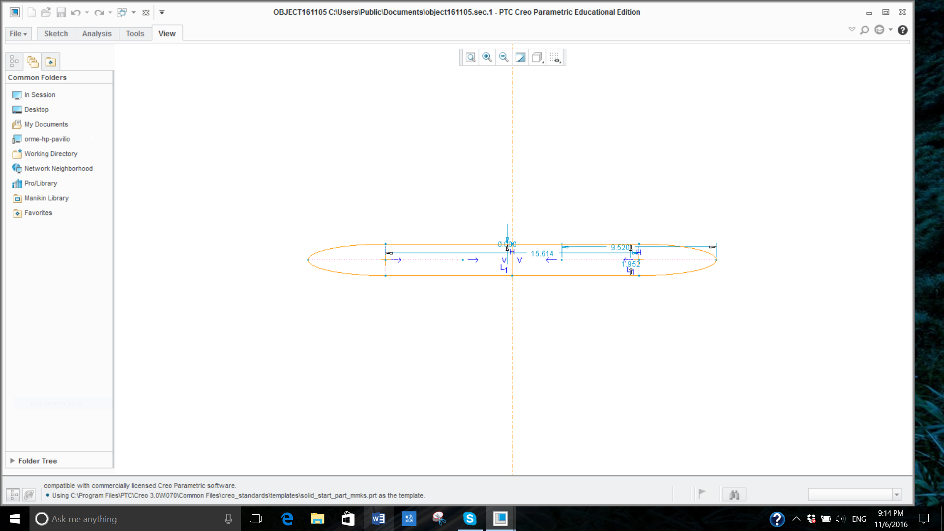

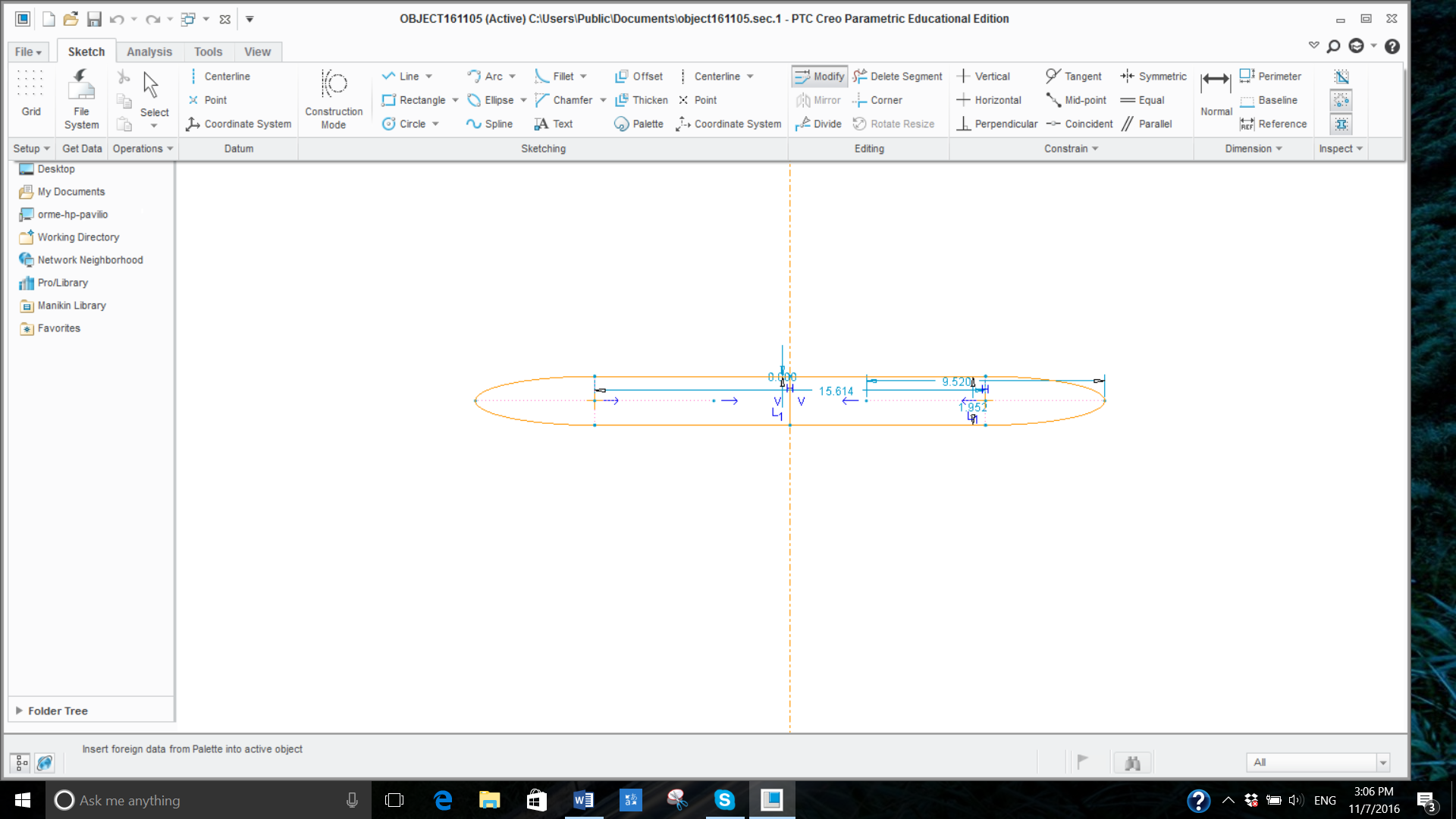

I have installed the Academic version.  I am trying to extrude the following sketch in the Part mode.Part161106.png
Note that the ends of this sketch use the ellipse tool in the Sketch mode.  If you use the Sketch available in the Part mode there is no ellipse tool.  In the Sketch mode there is no green check OK.
The answers offer do not pertain to the Academic version??

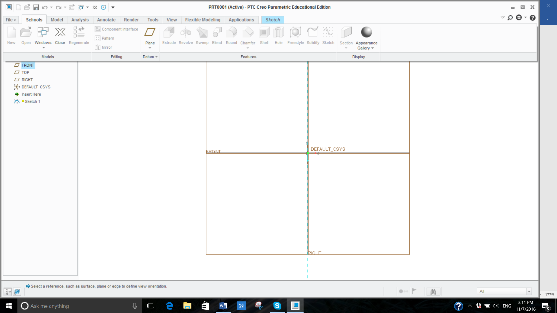

it seems to me that you do not understand basic principles of Creo.
The purpose of Sketch mode is to produce files with .sec extension. In Sketch mode you can define 2D shapes, ONLY.
The purpose of Part mode is to produce files with .prt extension. In Part mode you can create 3D model which consists of individual features. One of these features is Sketch feature, this means sketched 2D curve.
Note: In your Creo environment Ribbon interface is hidden. Launch Creo and press CTRL+F1 on your keyboard to display Ribbon interface.

Thanks for all the help.  I have found a way to import sketch elements created in the Sketch Environment into parts made in the Part Environment.  The path is not obvious.  First you must find the Palette in the Part Environment under Sketch.  It's in a dropdown menu under the "More" tab.  The file you want has a '.sec" extension.  It only shows up in the Palette if the Working Directory contains only .sec files.  When you see it you double click and drag it into the sketch in the Part Environment.
The key is finding the Palette.
