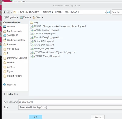

I need to be able to import .xml files into Creo.
I am using Creo Parametric - Release 5.0 (connected) 5.0 5.0.6.0
I currently only have export capability on my new laptop.

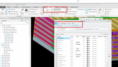

Jun 11, 2021 2:17 PM UTC
I do have a PTC support ticket open.
what I need to be able to do is export an .xml file from the Creo 5.0 of one part / assembly file to another.

Jun 11, 2021 3:30 PM UTC
So you want to add PARAMETERS to a Creo part or assembly?
Maybe you can try Creo Modelcheck to add any missing parameters:
https://www.ptc.com/en/support/article/CS52662
Sadly, I can't help you any further with Creo Modelcheck, as we don't use it.
