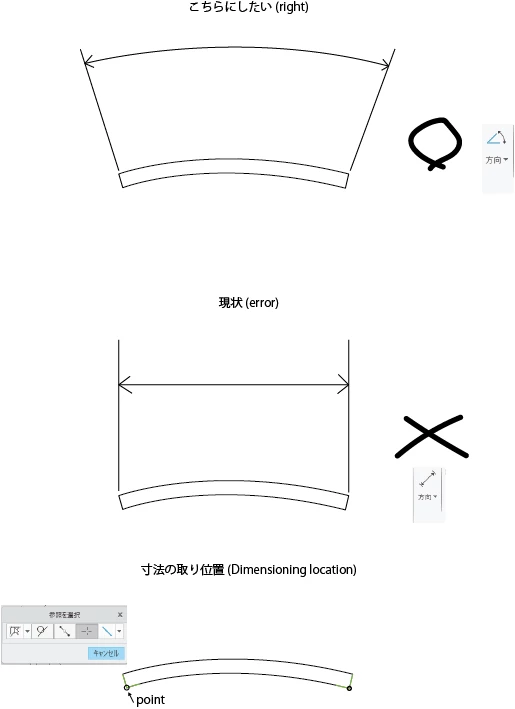

I want to make the dimension lines curved instead of straight
[Software] Creo parametric (ver 9.0.2.0)
[OS] Win10
[Question]
Please tell me how to make the dimension lines I've drawn curved instead of straight.
Translated text from Japanese to English using Google translate
Subject - 寸法線を直線ではなく曲線にしたい
Body - 【ソフト】Creo parametric(ver 9.0.2.0)
【OS】Win10
【質問内容】
描画した寸法線を直線ではなく曲線にする方法を教えてください。

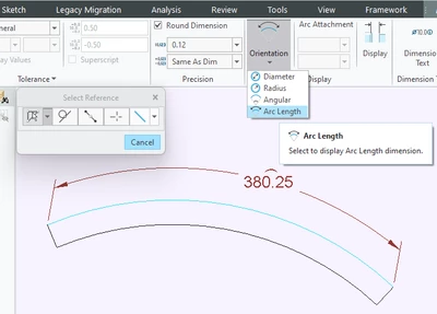

If you want angular dimensions instead of the linear dimension you need to pick the lines at the ends of the object when defining the dimension, not points.
kdirth
June 10, 2024
In sketcher, if you are trying to dimension the length of the curve, select the curve then both end points and place the dimension.
In Drawing mode, dimension arc then select arc length from Orientation menu.
