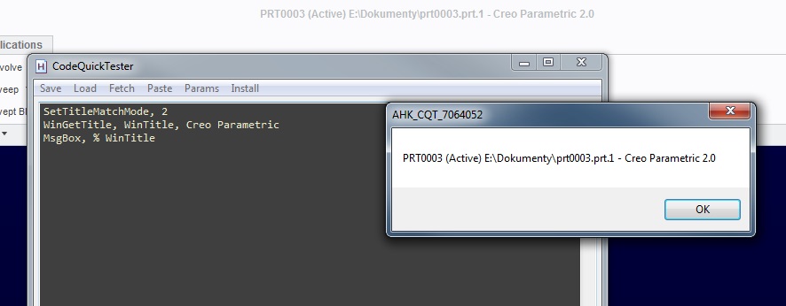

I just wrote a lil ahk script to get the window's title and ran it. See the picture bellow. On top is the win's title, on left-hand side is the ahk code and on right side is the resulting MsgBox with the extracted text. Should be easy to weed out the iteration number from there. AHK code can be compiled to an exe file, Creo can run exe files via OS Script mapkeys and populate a value of a parameter.
October 6, 2016
to refresh my knowledge I went to config.pro and found following option which has to be set to see numeric extension in window title.
display_full_object_path YES

Good catch, i got that config set up. Wouldn't know, otherwise. Thanks.
