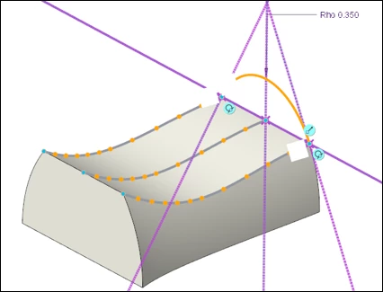

I'm wondering if anyone else has noticed this strange behavior of constraint icons or dimensions being lost ?
So far this is what I've found:
  • happens in creo 7.0.6 and 8.0.2
  • on an Nvidia machine Quadro P2000 and on a virtual AVD AMD machine
  • comes out of the blue
  • can be missing in one part and still visible in another.
  • restarting creo will often solve it.
  • Updating to the latest driver won't help
  • often on files originating from Creo 4
I'm not expecting advise or anything to solve it, just trying to collect more clues.

It's not related to those settings, as I have another example from a colleague working with the dark scheme.
The white blocks in this example actually should represent such a blue circle with the coincident icon (as you see above and beside it other examples).
