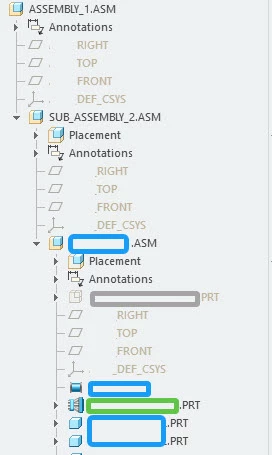

I am looking for a way to identify cabling/harness elements, specifically ".prt" type by using a repeat region.
So far, by using "asm > mbr > type" it is possible to identify parts, assemblies and skeletons.
By setting the repeat region to find certain properties in the parameters, I can identify sheet metal and piping components. But, I have not found a way to identify cabling parts. Yes, in my case I have them modeled from the cabling application.
Yeah, I know there are some repeat regions configured to list cabling/harness properties, BUT I cannot enter 1 by 1 in the subassemblies and set them as primary model for my tables.
Then: I need to find a way to identify cables from a master assembly or top level. It can be by invoking a parameter/properties to include in the repeat region that only cabling elements have. Or any other identifier.
NO: at this stage of the project I cannot add a new string parameter saying it is a cable. I have 100+ cable assembly elements, so it is not feasible.
Attached picture as example.
Thank you in advance.
