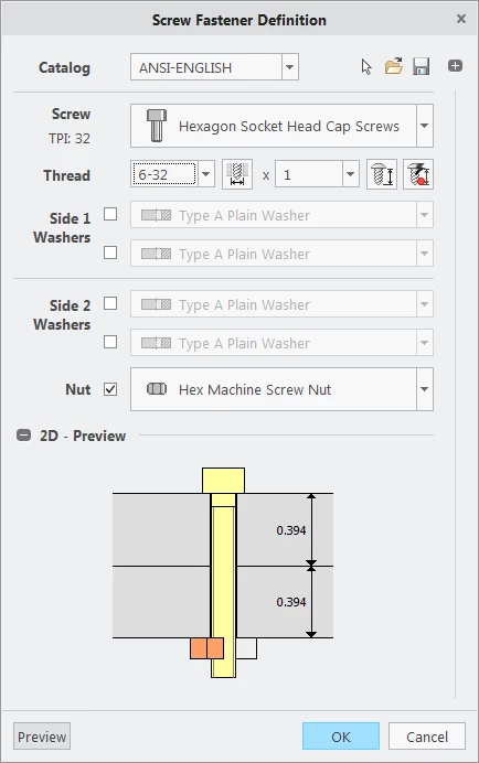

IFX cannot find ANSI fastener prt file
i have both creo 6.0 and 5.0(EDU) installed, when i insert mm/DIN fastener it seems to be fine, but if i choose ANSI bolt like 6-32 Socket, it will say csdd.prt not found. i did navigate this file, it's not in  ifx_fastener_data forder  but in prolibrary. i want to know how to add path of prolibrary with  ANSI standard to IFX, or how do i merge  all prt files from prolibrary to ifx_fastener_data folder.
August 13, 2019
if your problem is related to Creo Parametric 6.0, then I can tell you that there is a bug in $CREO_COMMON_FILES\ifx\parts\prolibrary\search.pro file.
Attached you will find original and corrected file.

in Creo 6.0.1.0 with wrong search.pro file I get error message
Model 'E:\PTC\Creo6_010\Creo 6.0.1.0\Common Files\ifx\parts\ifx_fastener_data\csdd.PRT' not found.
when assembling
In Creo 5.0.4.0 I can place the same screw successfully.
