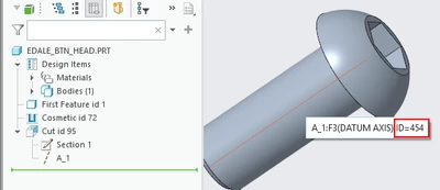

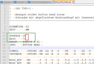

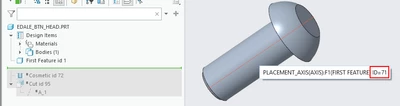

in your file 'EDALE_BTN_HEAD.dat' you specifiy the SURFACE=28 and AXIS=486.
I could found the SURFACE but not the AXIS inside your 'EDALE_BTN_HEAD.prt' file.
I could found an Axis with ID=454 and an axis with ID=71.
The ID of the 'A_1' axis feature is 451.
But I could not find an axis with id 486.
can you please try it again by using the AXIS=454.

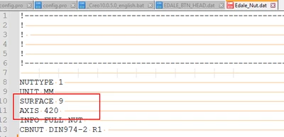

I had a look to your dat files.
Please remove the additiional tabs and spaces at the end of your SURFACE and AXIS entry.
Make sure that the ids are correct and exist in you windchill fastener part.
It is also possible to  specify a name instead of an id.
Use creo option 'show_selected_item_id' set to yes to get the id of the surface and the axis in the tooltip.
See also: Fastener Data Files - Placement References

I always recommend to edit the *.dat files with Notepad++ and display Tabs and Spaces.

6-Contributor
Apr 10, 2025 7:28 AM UTC
Hi Oliver,
Thank you for the response and answers.
This has solved the problem with the nuts, however this has not helped with the button head screws.
I went through the file on Notepad++ like you suggested and removed the extra tabs and spaces.
