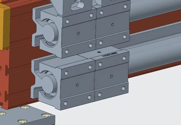

I have created a 10mm thick plate that has to be screwed onto four linear guide bearings.

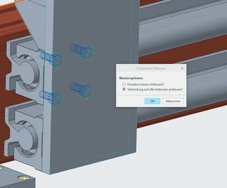

In the IFX-Diaglog I selected the face of the drilling and the front and back-face of the plate. Then I selected the screw that I want to use. After that IFX asks me, if I want to create a single screw or if I want to insert the screw on all instances. I selected "insert on all instances", but the screws are only added to one of the four bearings(4 of 16 screws).
When I try to use the "reuse"-command its not possible to select the face of the drillings of the other bearings.
To create the other screws I created four new screws for every bearing. It works, but its not very nice to change the size of the screws, because I have make a change four times (for every single bearing).
Is it possible to add all the screws to all four bearings with one feature?
Maybe someone knows a better solution ?
Maik

Hi Maik,
do you have another reference for your holes, e.g. an axis or a point?
You can send me your part, then I will have a look to your reference. The linear guide bearing should be enough to test it.
Another workaround: Create a point feature with 16 points in your main assembly and reference on the drilling surface of your holes.
Oli
