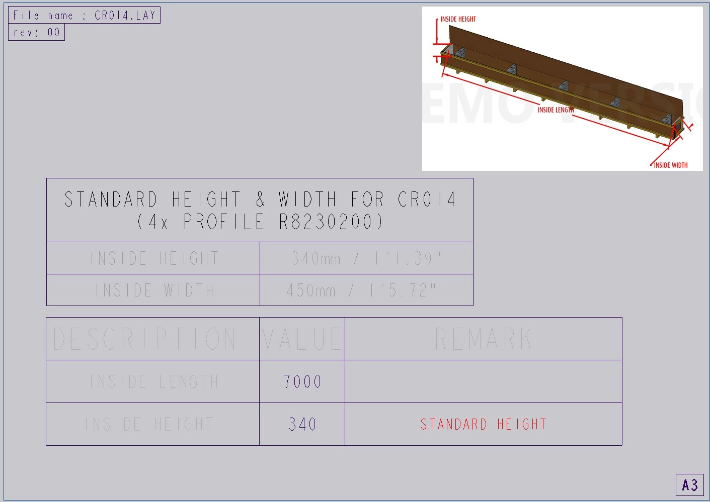

Image in Notebooks appear as OLE box and don't show graphics
As I recall, importing image in Notebooks was possible in the past. Currently, there seems to be an issue with it. Sometime importing a jpg might pop up, but most of all you get a frame showing 'OLE' and the imported file name, but no graphics.
I can't seem to figure out what the root cause is. Importing an existing JPG file as an object seems the only way to do in a notebook, while a drawing has a specific Images import command
Anyone knows how to solve this?
Using Creo 9.0.4.0 and to my knowledge this worked fine in Creo Parametric 7

if you changed computer and Windows version than the problem is related to this change.
Try adding picture in bmp format.
Nov 25, 2024 12:03 PM UTC
No, unfortunately BMP format does not solve the issue
in my Creo 9.0.2.0 (Windows 10) I can insert bmp file.

Nov 25, 2024 3:53 PM UTC
Any IGES, DWG, or DXF file can be imported into a notebook. This is according to PTC documentation. I have only used these file types to bring in graphics data, are you certain that JPG files were working in the past in notebooks (layouts)?
