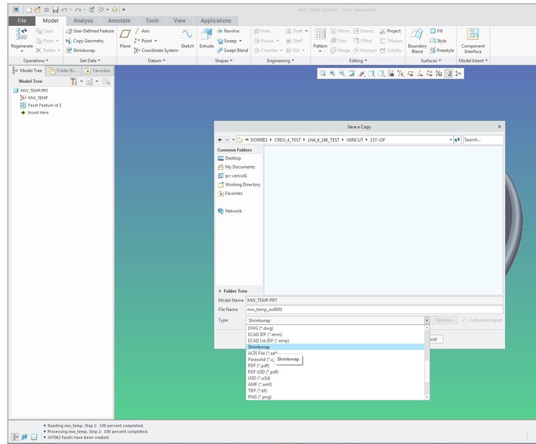

Hello David
We have a method that takes a 3d scan that is a mesh shell in STL format , and convert it into a solid part in .PRT format.
it uses the "save as" with "shrinkwrap"option
see below
It converts the STL shell into a solid part.
I have put in my dropbox a brief how to, that we use in PDF format on how to use the above option
It is at https://www.dropbox.com/s/6qa67d3iepn2969/CONVERTING%203D%20STL%20OUTPUT%20TO%20CREO%20PART%20FILE.pdf?dl=0
One thing, you have to make sure that the shrinkwarp option is set up in you save file option. That I don't know how to do, I just know it is set in my options
Peter
