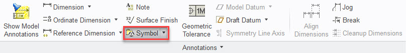

I have a 2D library that I would like to import as central catalog in schematics. Problem is I didn’t find any documentation about it, and I didn’t succeed to find a way to work on this library from schematics. I saw that this question was already asked in other discussions but the links for step by step instructions to create a central catalog are not valid anymore.
Maybe I don’t do the right steps to import it?
Maybe it is important to precise that the 2D library I have was created with CreoParametric-Drawing. The files have a *.sym.1 extensions. I saw in other discussions that the extensions need to be *.art, *.mm *.dt and *.dep. Is this still true?
Some help on this would be greatly appreciated, I hope I have been clear.

Gaby, I agree that creating the Central Catalog library items directly in schematics is the most efficient way, no doubt about it. But i already have an existing set of symbols existing in Parametric (let's admit that i can't re-create all those objects in schematics)
I may not have been clear on this but the entities I want to import (as blocks or groups) in Schematics are symbols (with the ".sym" extension)
So what i need to do is : Open each symbol, save it as .DWG (as adviced by Bill), then go in schematics, go to catalog explorer, create a block, import the .dwg in the geometry tab, save the newly created block (after editing the parameters). => do you confirm this method that i deduced from your explanations?
I then have then the following questions :
1) Isn't there a simpler way to automatically import all symbols as blocks in schematics?
2) Do I have to manually create all folders in the central catalog in schematics, even know that those folders already exist in parametric (I am talking here of the tree view)?
3) I don't get how to create a central catalog which can be seen and used by everyone, and there is no information anywhere explaining how to do it, would any of you have a link giving a step by step method to correctly implement one?
