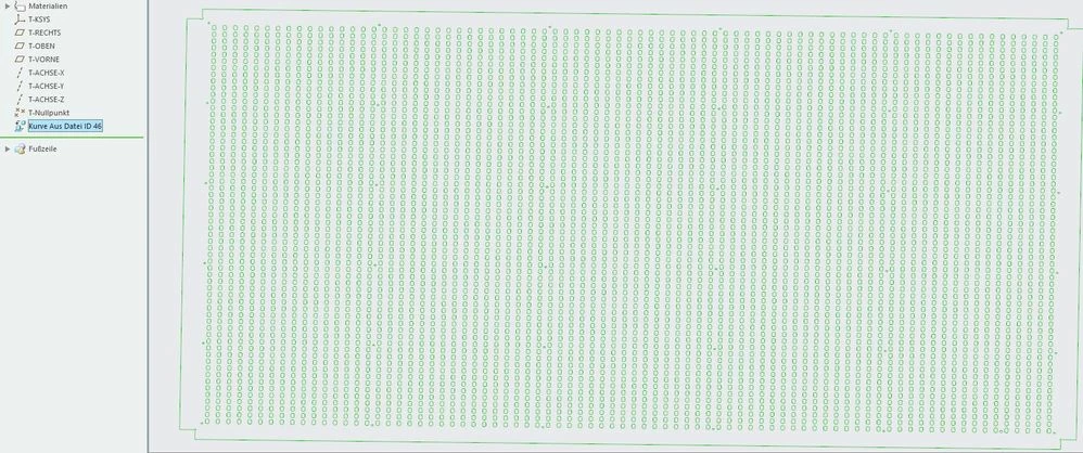

I want to import a dxf_file with 8400 holes in it and extrude the curves.
I clicked on File->Open-> (dxf-file) -> then I selected "part" ->open
The dxf-file is imported as a curves. I tried to project the curves to a new sketch, but its not a lot of fun to select 8400 curves one by one in the project-command.

your holes form a regular pattern. Suggestion: Do not import DXF, recreate holes using Creo.

Thanks Martin,
The holes are elongated holes/Slots. It works to extrude one of them and to pattern the extrusion but it takes a very Long time (About 30 min).

in pattern definition go to Option tab and change Regeneration option value to Identical (holes do not interfere). This setting will reduce regeneration time.
