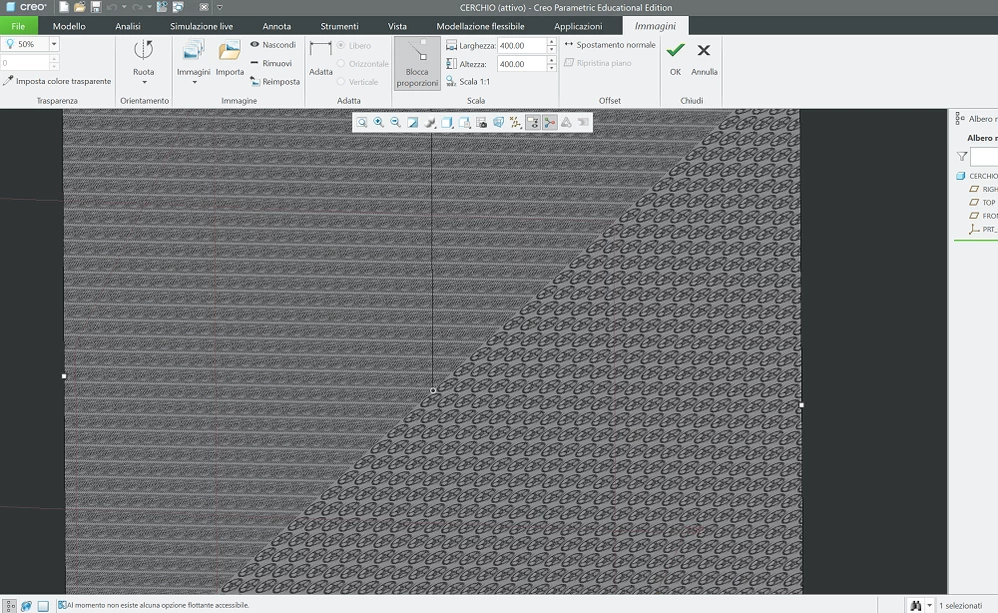

Hello, I'm trying to use an image as reference for my model. I tried to add it but the image is really confused. This is what I have:
I don't know why I have this result. Could you help me?
I use Creo 6 Student Edition.
kdirth
November 8, 2019
I just dealt with this issue on my computer.  The graphics driver is the problem.  I had an updated driver and had to go back to an older driver.  Everything is working for me again.
Changed from 4.6.0 NVIDIA 440.97 back to 4.6.0 NVIDIA 419.17
