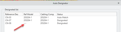

Is it possible to import multiple XML files, from Creo Schematics, into a single Creo Parametric Cabling component? In the past, my attempts to import multiple XMLs has caused the the new one to overwrite the old one.  I figured out it's possible to manually copy and past information from one XML into another using Notepad++. It's an inelegant solution and prone to error, but it does seem to work. Does anyone else have any better ideas?

the sort answer is yes , the long one is :
  • if xml files contain parameters/info which referring to same objects (i.e. same connectors, same routed items or same spools) it will be overwrite/updated .
  • if xml files are different - i.e. referencing to different connectors, spools or routed items it will accumulate to exist logical data in the model
  • it does not work smooth :
    • if connector appear in 1st xml but does not appear in the 2nd one - it's ref model might disappear from auto designate dialog (but it still be designated):
    • spools which are marked as come from logical data will be editable (will behave as created manually in Creo ) if they are not in the 2nd xml
these issues can be workaround by including all spools and connectors in all xml - assuming difference between xml files are the routed items (connectivity between different connectors, routing of different wires/cables)
