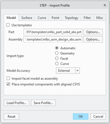

I'm using Creo 11.0.1.0
When I import a STEP File that was created with Siemens NX 11, there are a lot of surfaces that fail.
By optimizing the import settings, the load time was improved, but the surfaces still aren't ideal.
Can anyone share a STEP Import Profile configuration?
Thanks for your help!

I do not have any Catia specific import suggestions. I would use the same STEP protocols on both ends if possible.
In some cases, you may get better results when importing if you match the absolute accuracy (units of length) in Creo to that of the Catia source file. So set the start part template you use in the import to match the absolute accuracy (resolution?) of the CATIA source model.

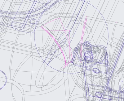

The Problem is, that we really don't know anything about how the STEP File was created, beyond the header of the STEP file and that it is data from Mercedes Benz. I made an error thinking it was a CATIA file it is actually NX.
There are intersecting surfaces in the STEP models which cause the surfaces to fail.
We have a potential customer, who is thinking about switching to Creo from Catia, he says the STEP files open without problems in Catia and won't switch if Creo can't handle it.
