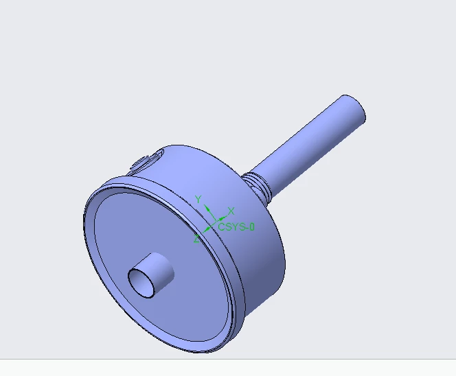

Hello dear members, trying to import file from following link in Creo, but its not importing properly, could anyone suggest the correct procedure to import? I tried importing but results are not satisfactory (see image below)

You have not said what is not satisfactory.  However, looking at the image, I see two things.  The tube is too long and the part is not solidified.

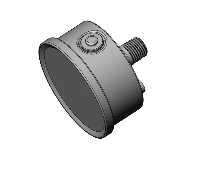

@kdirth Desired solution will look like one attached below ( STEP imported to Solidworks in my colleagues computer), so imported file in Creo is not satisfactory

That looks exactly like the result I received downloading the step file from mcmaster.com and importing it in Creo 7.

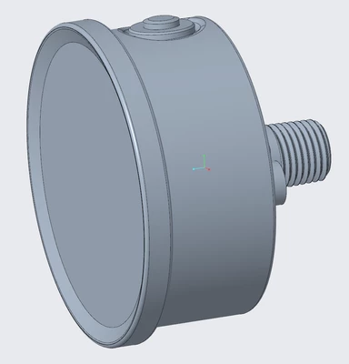

I tryed to import STEP file unchecking the option "Simplify surfaces" With this option off, the result is ok for me (using Creo Parametric 10.0.0.0 but also with previous versions) Working with other options may change the result (better or not). Many times excluding this option I get better results (even with native formats like Solidworks or Inventor)

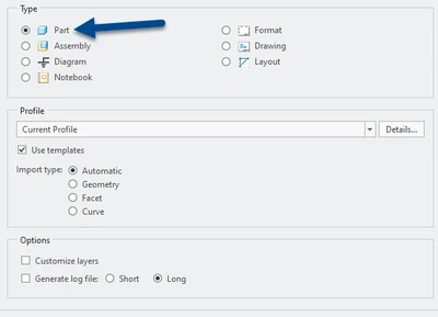

A few things:
I always recommend step files to my users. I downloaded this file as step and it imported just fine.
We do have import templates set up so that we get the desired geometry/metadata in the newly created part.
My preferred method of importing is drag and drop. I stored the file in my downloads folder and drag it into my Creo window. Generally, I drag into an empty window or a single part window because results vary (or used to) when dragging into an assembly window.
Keep in mind that there are rules when it comes to file names and number of characters in a path. I've seen this mess with imports as well. This is why I use my downloads folder or desktop.
I don't recommend changing the Type on the import screen. If your step wants to import as a part, let it. If it defaults to assembly, let it. Import the file and then change it.  I'm wondering if this is your problem.
I downloaded the step and let it import as a part and it looks good. When I try it as an assembly, it looks like your screenshot.
