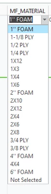

Recently I've created a parameter set for selecting a material from a drop down.  This list drives relations used for grabbing dimensions for an auto-bom table.  I'm having trouble importing this list via .txt file, and I'm wondering if there needs to be a specific syntax for the strings int he .txt file?  This list is pretty simple:
"1X4"
"2X4"
"2'' FOAM"
etc.
I have been using a mapkey that creates the parameter, and then adds each material, line by line.  As you can imagine, this is pretty tedious to update..
When I try to go into the parameter and right click in the list window, select import, and select the .txt file, nothing happens.  Any thoughts?

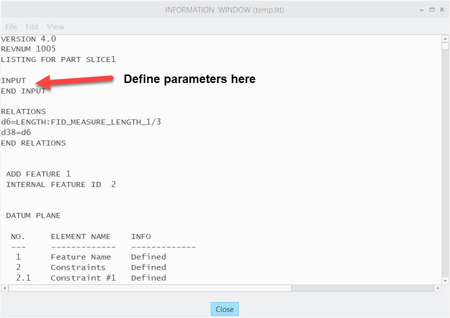

If you are looking to automate the setting the values of multiple parameters in a model then Pro/Program may offer the solution. You can define the parameters in the input section. With this defined, upon regeneration of the model you will be prompted for the source used to assign values to the parameters. One of the options will be from file which will use a previously created text file to define the values.

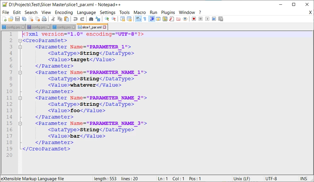

One option is to paste the text file contents into the relations definition UI which will create the parameters. You should then delete the relations made from the pasted data once the parameters are defined. You can then export the parameters in xml format for use in importing into other models. When defining strings in the relations UI you will need to use double quote marks as shown here.
parameter_1="string value"
In my example above for the 3 string parameters, this is what the xml file syntax looks like. An xml file may work out better for what you are trying to do. You should be able to use this as a template to generate an xml file in a text editor to define a list of string parameters.
XML file syntaxXML file syntax

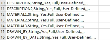

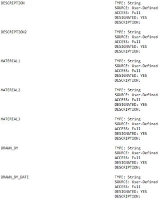

Here is what I get in a txt file:
I believe you are missing the definition of the parameter columns.
Here is what I get in a csv file:
Each column separated by a comma.

Thanks @kdirth !  Does the information you provided apply to a restricted values list parameter?  I'm trying to create a drop-down list of values like in the image below:
