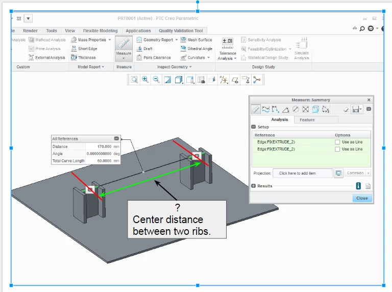

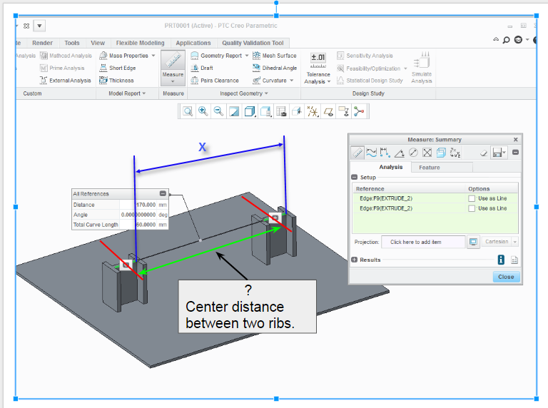

In creo Can we measure center to center distance between two feature for example distance between the center of two ribs.
  • February 16, 2017
  • 9 replies
  • 6240 views
Measure summery tool in Analysis tab in Creo doesn't give the distance between the center of two feature.
See attachment for further details.

Anyway, you can create datum points on the line segments with a ratio of .5 to place them at the middles of the line segments. Alternatively, create datum axis points in the original sketches that are at the desired location so they will be available to make this measurement.

I was going to suggest the same as David.  Create datum points and the desire locations and then measure the distance between the datum points.

I agree with your answers but again these datum points will serve only measurement purpose and may increase model tree. If model is open by another person in future and in case he/she highlight datum points there are few chances that he will understand the purpose of these datum points. And in case if he conclude that these datum points do not have child feature they will become an unnecessary feature for him also it increase the model tree which will impact CAD model regeneration time.
Let me know your thoughts.
Many Thanks.
2-Explorer
February 17, 2017
Create datum axis points in the original sketches that are at the desired location so they will be available to make this measurement.
Then no increase tree, not forgetted.

As a workaround if the parts are symmetric, you can use the surface to surface measure at the ends as shown that gives the same result as the center to center measure.

I agree with all of your suggestion. They are very helpful. Apart from that there is one thing that it would like to highlight I am not sure whether it is proper place to say it or not, but It will be very helpful and great if PTC will improve "Measure Summery Tool" in Analysis tab to measure Center to Center distance between two unsymmetrical feature (like twp ribs, or walls etc.,...) as shown in attached snap shot to discussion subject.
