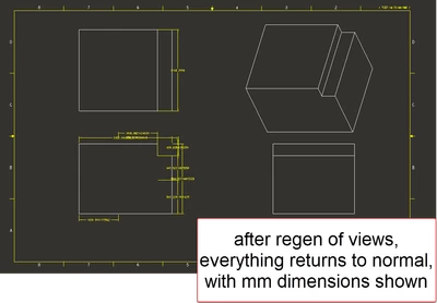

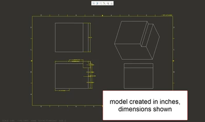

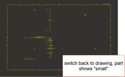

I did a quick test. I made a part in inches. I just used random numbers.
I created a drawing, showed the dimensions. I didn't try to make a good drawing,
I then went back to the model, changed the part from inches to mm.
Initially, when I returned to the drawing the views were "small" compared to the original.
I regened the drawing views and all came back as if nothing had changed.
See images.
