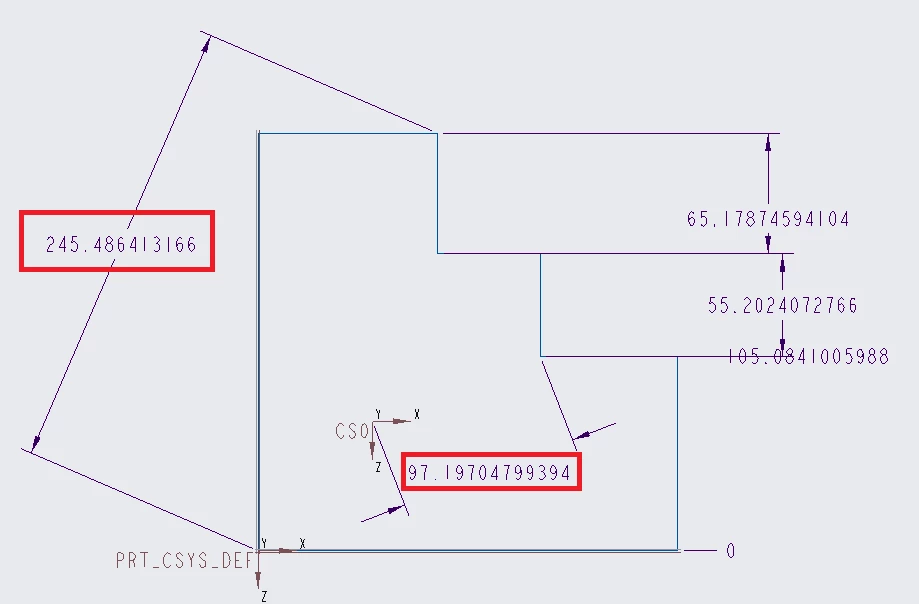

in drawing, is there easier way to dimension from Csys origin?
1) I have a customer part with a datum structure where the origin is off in space.
2) I figured out how to add a Csys to my Model
3) I was able to use layers to get only that Csys to show up in my drawing view
4) Creo wouldn't let me dimension off the Csys.
I had to create datum planes using the Csys and then datum axes using those planes.
Using Show Model Annotations was finally get dimensions on in drawing with the axes.
Is there an easier way? or at least cleaner? model is going to get very messy with this process.
(working in CREO 6.0.2)

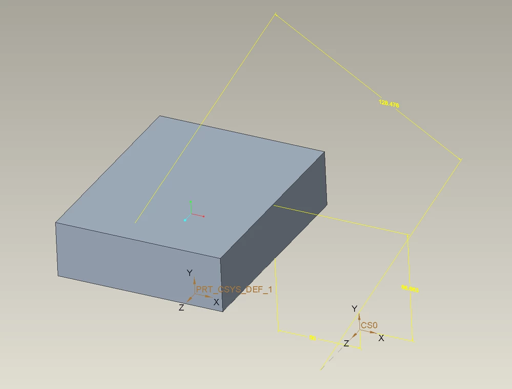

It is possible to create model annotation dimensions. This shows dims relative to an offset Csys feature created in a part. You can then display these in a drawing view.

if I understand you well you need to create drawing dimension. I tested Creo 6.0.4.0. I can select CSYS name and model vertex (for example) and place dimension ... no problem.

Works in 4.0 as well.
