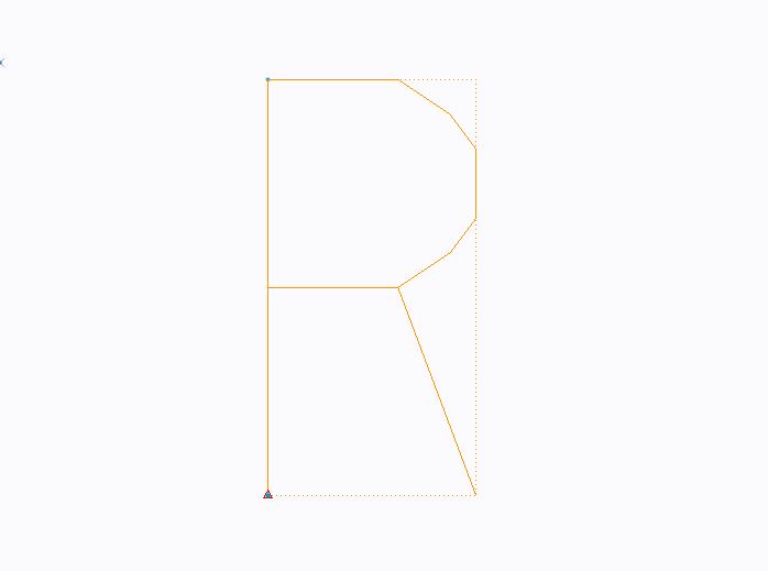

    Paul,
    I do not think that usage of Creo font leads you into troubles. You can test existing fonts to get some experience.
    The trouble from your point of view is fact that Creo font are composed from straight lines (you cannot define arcs and splines to get smooth character outlines).
    Example of Creo font source file:
    Creo2_LOADPOINT\Creo 2.0\Common Files\M070\text\usascii\ascii.src
    Information concerning Creo fonts:
    See attached PDF file, start on page 119.
    If you want to create your own font you have to take a paper with square grid and sketch your characters using straight lines. Then you have to described pen movement using m and d commands. There is no software editor available (I mean free of charge software).
    At the end you have to translate source file, put it into appropriate directory and also create ndx file.
    Translate command entered in Command prompt window (Windows 64-bit):
    setenv COMPILE_FONT_PMT 36
    compile_font.exe myfont.src myfont.fnt
    Conclusion: Creation of Creo font is VERY complicated and time consuming.

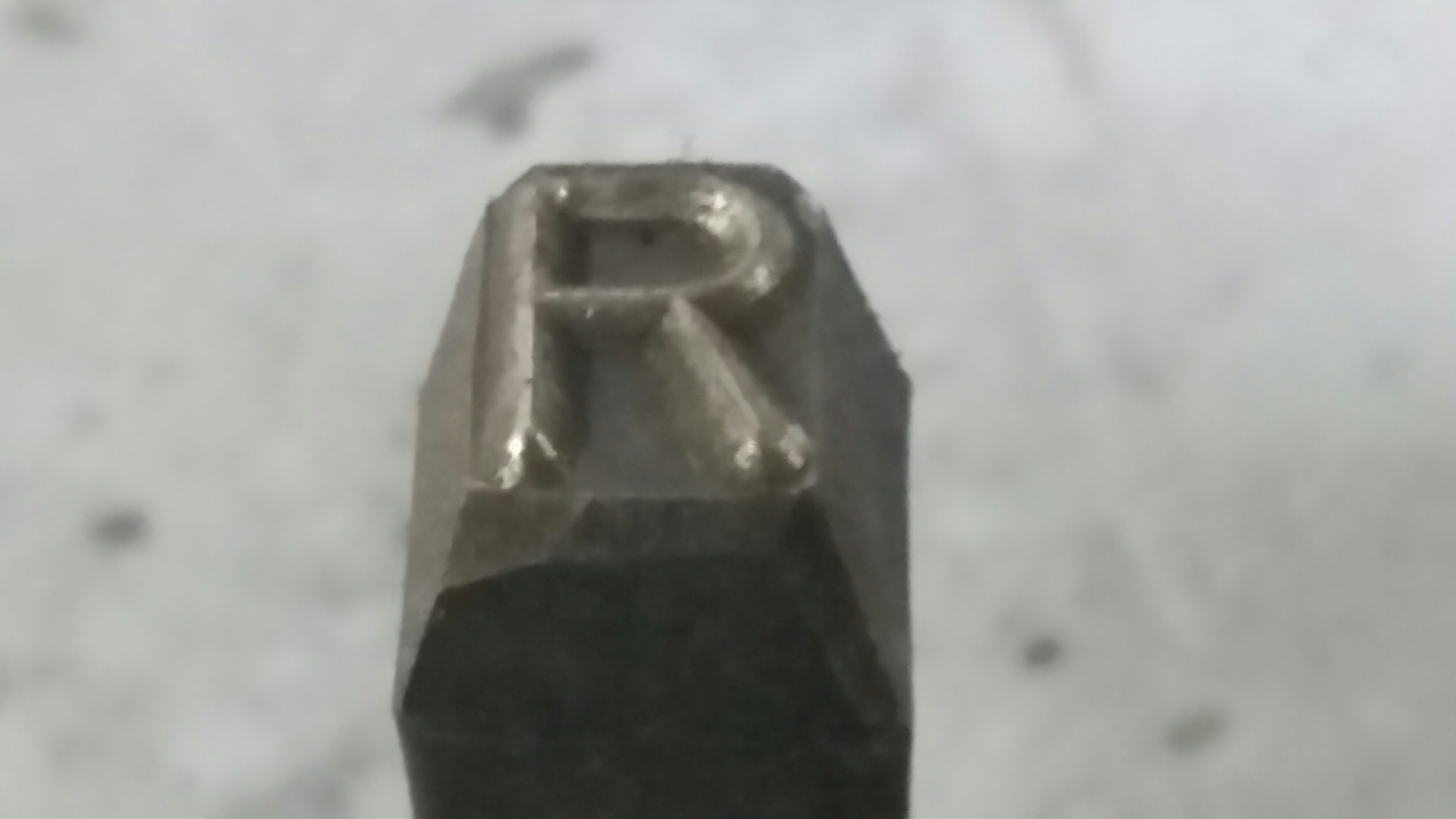

    Paul,
    please can you attach some picture of your hand stamp. Also can you explain the term "windows fonts are double line walled" ?
    Martin Hanak
    pimm15-MoonstoneAuthor
    Mar 19, 2015 3:05 PM UTC
    Martin,
    Here is what the hand stamp looks like.
    Here is what the supposed correct true font looks like in Creo.
    The hand stamp comes to a sharp edge and is angled back from this single edge.
    The true font equivalent has thickness all around the letter. This will not machine correctly.
    Creo does have fonts that don't have the thickness as shown below.
    This is what I need, but I need the true type font to match the hand stamp font we have.
