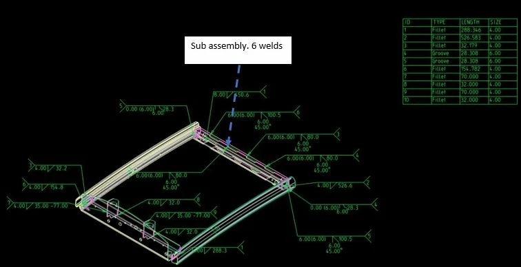

Hello. I am trying to make a drawing table for weld information that has all of the weld information for the entire assembly including sub-assemblies. When I create the table in the main assembly the table is only populating the information from that main assembly and not the sub-assemblies. Any help on how I can accomplish this would be appreciated. Attached is a pic of what I got. Notice the annotations are there for all of the welds but the table only has the 10 welds from the main assembly. there is also duplicate IDs due to the sub-assembly welds.

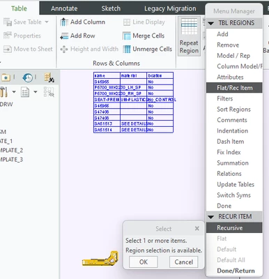

I would expect this to work similar to a BOM.  In the repeat region menu, select Flat/Rec Item, select table, select sub-assemblies, and select OK.
Mar 8, 2023 7:39 AM UTC
Additional info >>> Recursive option is also available in Attributes menu.
