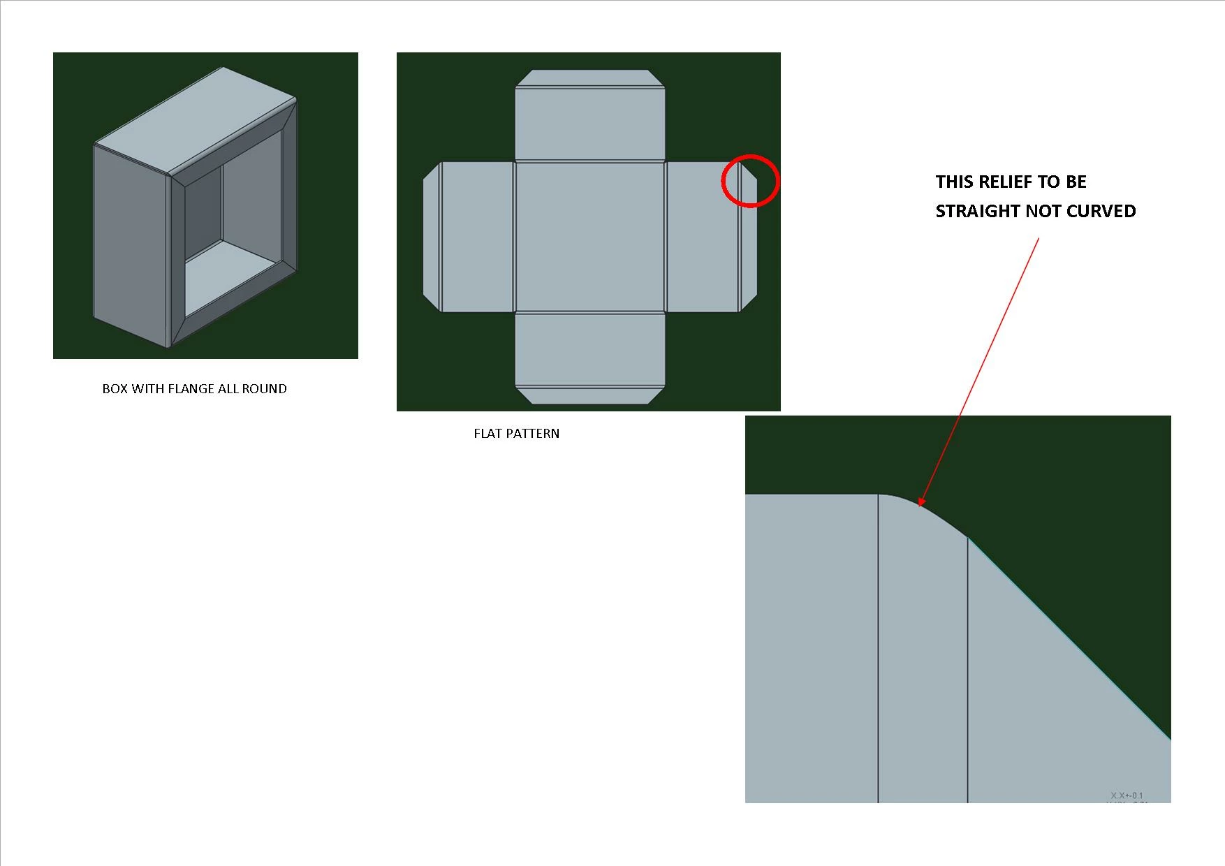

Hi all new to the Forum hope you can help me with this problem
i have for years used the the flange command in sheet metal to create sheet metal mitred flanges.
I have always just sent the flat patterns to the fabricator as dxf file and let them deal with the profiles of the flatpatterns in most cases proe/creo will add relief to the flanges which will curve the profile and for years this was ok but now the fabricator wants all relief to be straight on the mitre flanges i cant for the life of me get creo to give me an output without curves on the mitres
Any help on this would really be appreciated please see attached pics and file which will explain exactly what i am looking for
Thanks in Advance G

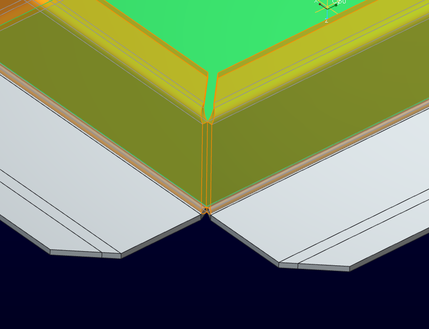

The "problem" is the gap definition. You have a zero gap on the side and the top and to do this right, it has to have the transition through that bend.
To do what you are asking for means you would have a small gap on the top flanges (the 45 miter) and no gap on the vertial edges.
So as Andrew said, "unbend" the part and miter the edge and then "bend back".

I was really hoping that this was a simple box i havent ticked or a setting that i havent added. But unfortunatley unbending and cutting the mitre out and then bending back looses all the time that i saved using the flange command in the first place.
Because this material ranges from 1-3mm the curves that creo create are only a hinderance to the fabricator who punches and laser cuts these parts so a requirement for the 0 bend allowance and straight edges is a must in manufacture time.

You could also add a small flat portion to your flange. This doesn't help with the time portion of you problem, but would eliminate the curves when flat. As mentioned before, there isn't a quick 1-button way to eliminate this problem.
