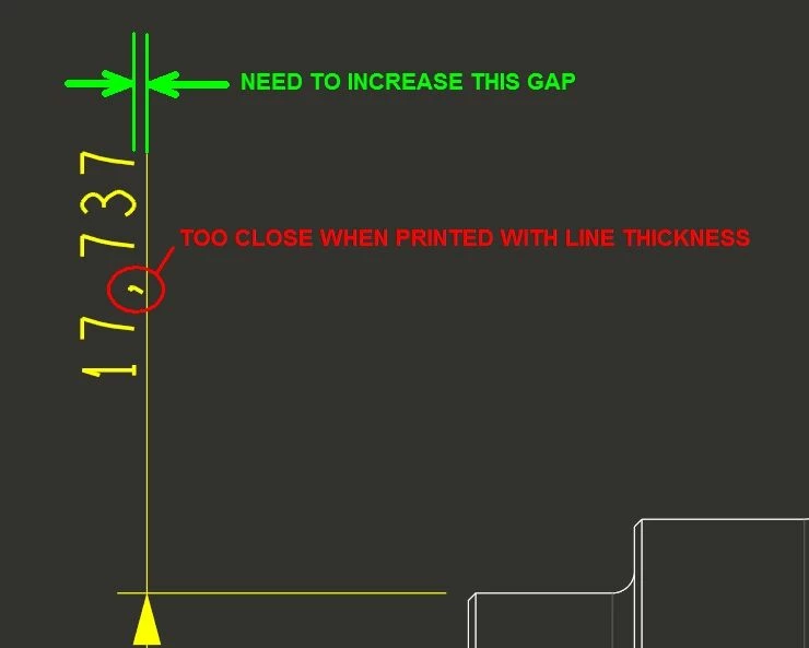

Is there anyway to increase this distance, when printed many characters are touching the leader line?

I don't think it's possible.
Information from PTC support:
For Creo Parametric
  • If drawing option default_lindim_text_orientation is set to horizontal
  • If drawing option default_angdim_text_orientation is set to horizontal
    • drawing option dim_text_gap can be set to control the distance between dimension text and the leader line
  • If drawing option default_lindim_text_orientation is set to others
  • If drawing option default_angdim_text_orientation is set to others
    • There is no way to control the distance between dimension text and the leader line
    • To request this functionality, refer and vote for Product Idea 5034
Product Idea:
https://community.ptc.com/t5/Creo-Parametric-Ideas/Increasing-gap-between-the-text-and-the-dimension-line/idi-p/458539
