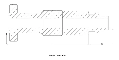

How do you commonly indicate a painted surface? As an example we make some parts out of ADC12 but they are painted only on the outer surfaces? I can give the part the correct material but then if I would like to add a surface treatment, how would I do it?

There is no "standard" for surface coating indications on drawings or models. You will likely have to develop something that works for your company/applications.
For drawings, we've done all kinds of stuff to convey to manufacturing (internal and external).
the one below shows something that looks like dimensions to show different coatings on different areas. We've also done hatched areas, surface coloration (sometimes difficult due to b/w printers)
