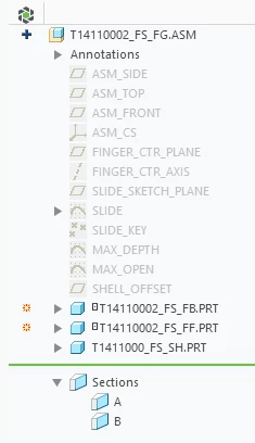

    This is from Creo 8.0.0.0:
    May 26, 2021 6:07 PM UTC
    Starting in Creo 7 the "Insert Here", or Insert Indicator, was switched to the green bar. It behaves identical to the Insert Indicator in that you can drag and drop it to enter Insert Mode. Then RMB > Exit Insert Mode to exit.

    see green horizontal line in picture uploaded by TomU. This is former "Insert Here" bar.

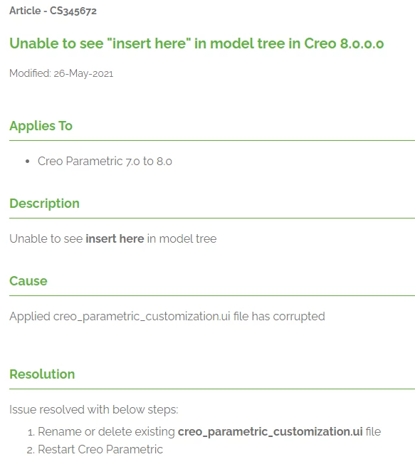

    Not sure if this is your case or not, but this article just rolled out from PTC:
    https://www.ptc.com/en/support/article/CS345672

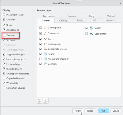

    May 5, 2022 10:10 AM UTC
    It's the same in Creo 7.
    Go to the model tree settings and make sure "Features" is selected.
    If you press apply, the bars should come back.
    I'll log another case to E-support and suggest this as a change.
