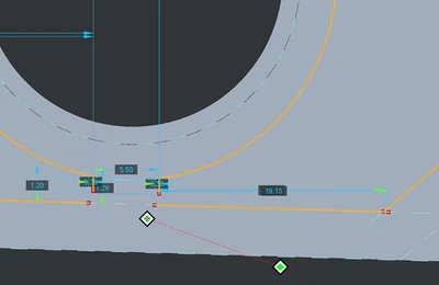

Has anyone else been having trouble in 9.0.3.0+ with the offset tool not updating references, completely falling apart or flipping around? I'm not even adding or deleting references, just moving existing and it keeps breaking.
I've read up on the Articles and Posts, but none of them explain the instability.
I opened a case with PTC TS and an SPR will be filed.
Examples:
Movement of bottom surface not automatically updating the references:

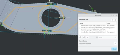

Movement of bottom surface causing all entities to lose connection to each other:

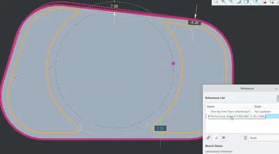

Edit outer profile dimension, causes offset reference to be lost

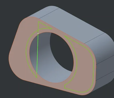

Change hole to thru hole causes one side of profile to flip, but not the other?
