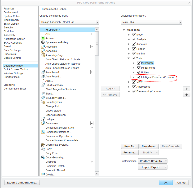

I hadn't realised Creo 3 now has fasteners built in. Great. I've seen some tutorials, all looking good.
But, and I apologise if this is a stupid question, it just doesn't seem to be visible. In the Tools menu, I don't have the IFX group, only Investigate, Model Intent and Utilities.
I've checked my configuration, and afx_enabled is set to yes as is intellegent_fastener_enabled. Looking at customising my ribbon toolbar, it's not listed in there either.
I understand the full extention is a licensed add-on, but thought the "lite" version was included? I have all the files in the "Common Files\afx" directory.
What am I missing?

Xavier,
check your UI settings - see picture.
Martin Hanak

Thanks Martin,
But it's not there.
Ahh, sorry, blonde moment. I wasn't in assembly, only in part modelling. If I go to make an assembly, it then appears.
The reason I wanted it was to use it was to include studs into my model. But I guess it's purely for removable fasteners in which case logical it's only in the assembly module.
I suppose if I want to create a threaded stud to be part of the model, then I need to do it the old fashioned way?
