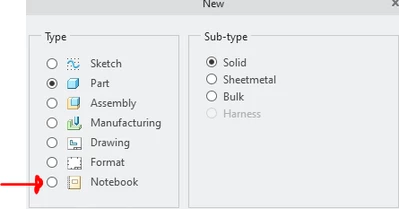

Hello @MK_9183946 . If you want parameters to be called whenever you want them  , use NOTEBOOK in creo to store parameters. They become global which can be accessed whenever needed.

Hello Lewis,
thanks for the hint, i never used Notebook as i am just starting with Creo, would work a Mathcad sheet the same way as the Notebook or is there still some difference in it?
else the problem is that i have several components from an interchange assembly that i want to swap, they have the same parameter names with different values, and i want to have that the different values in my assembly automatically just with replacing the component., as they are just three angles that different i created a measuremetn analysis in my assembly and the angles i used planes for to measure them and these have the same reference tags so it gets the job done, but looks like a messy workaround, pretty sure there is some smarter way in doing it.
