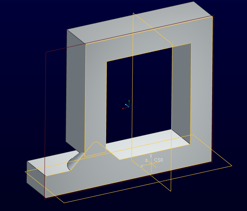

I was using an offset feature to resemble a weld between a tube and a bracket.
The features looks well enough in the model but there is a strange issue with and Offset feature... it doesn't merge with intersecting solids!
Here is the feature itself:

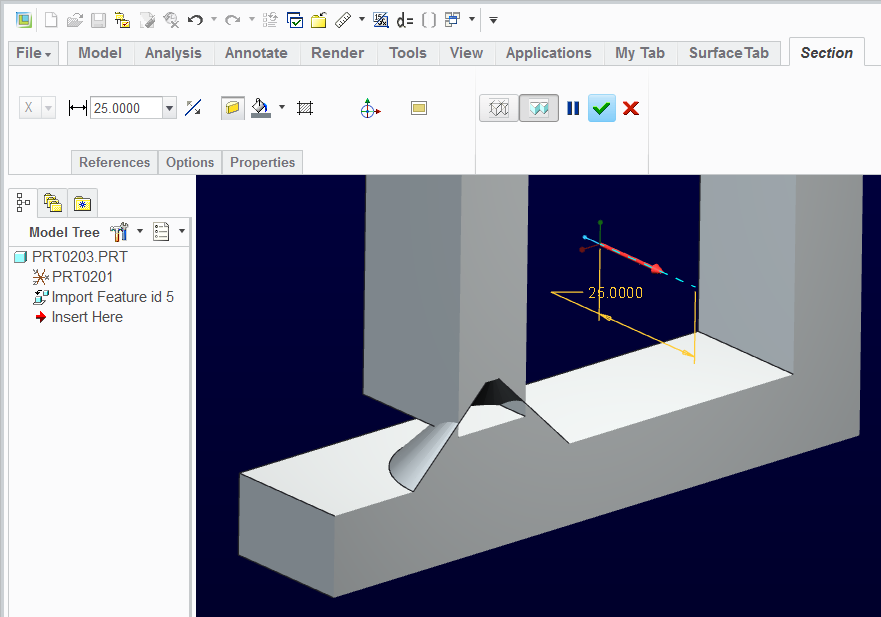

Funny thing is, you can trim with extrude across the feaure and remove material.
So I had to cut and refill the feature. This worked okay here but was not nearly as simple in another region.

I have attached a quick sample file of the issue:

In the example case you show it makes a solid feature but does not recognise the intersection with the other leg of the solid. It is as if it has made a surface feature but filled it from below with the surface boundary remaining in the other solid as it would if it was surface only. This is M060
As a complete change of tack how about a projected curve as the base of your weld and a sweep (for me VSS) to give the inclined wall and then use solidify? Very robust. If you are really keen you can copy the surfaces of the tube and the block then merge these to your sweep to get a surface volume which you then solidify but unless you need this volume for something it may be over the top.

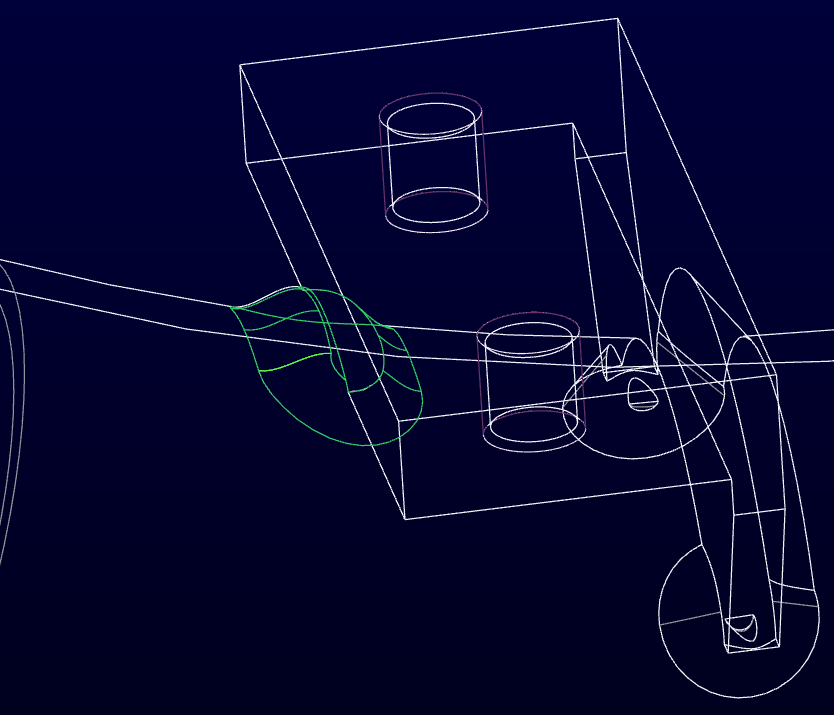

I thought of a couple of ways to do this but it is a simple representation. Extrude-cut through it and refilling fixed it, but just seemed weird to have to do this. It really is a neat trick to show a weld, don't you think
In the original example, the weld is on a bend in the tube, and it is not normal to the surface. It wouldn't even let me wrap a sketch onto the surface. I had to offset the surface by zero and trim it with a revolve surface to even get an edge to sweep along. Of course, the weld feature didn't recognize this as a valid connection either.
This is how you get corrupt solids as exports. Not acceptable!
