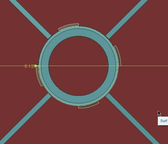

Hi All,
I want to put 4 welds around a pipe.  The pipe is welded to the flat plate.  The issue is that I want the welds to be centered on the quadrants, yet Creo seem to only want to start at the quadrants..
I can't seem to set a negative start point, and the 'center welds' option seems to be broken..  And I can't see to set a uniform way to get these welds..
Upate:
So, my work-around is this:
Create 2 work planes so I can define my start & stop of the weld (and make sure they are on each side of a plane that is  mid of the selected semi-circle of the tube / cylinder - this seems to be an issue)
 - create weld, and select the start & stop planes.
 - polar array the weld.
Just seems like an awful lot of work for something that seems soooo trivial & simple, and Creo seems to offer tools for it. (but this is Creo, so I expect some needed weird & convoluted work-around..)
Of course, when I try to do my inner weld (same work planes) Creo is deciding that the start & stop are other other side of the work planes, no matter how I try to put the welds. (so instead of a nice 30° weld, I'm getting 150° welds, despite my start & stop points show a 30° weld!)
So, I create 2 new work planes for this weld.
so frustrating!
