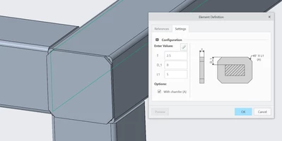

I'm trying to create internal end caps on a framework assembly I generated using AFX. I'm used to being able to do this in SolidWorks (see documentation) but I can't find the equivalent in Creo - can someone please show me where I'm going wrong? Does this exist in a different menu?

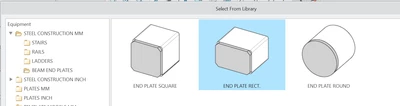

The closest I've found is the 'New Equipment Element', but this only generates external end caps and with a chamfer, not a radius. I'm expecting the tool to grab the radius from the RHS profile definition and able to be set internal/external dynamically.
I've tried setting the 'T' parameter negative to achieve something similar but to no avail.
Any help will be much appreciated, thank you!

If you uncheck "With chamfer" you can use Round on the corners afterwards, as the generated end cap is a solid. It's a manual operation but returns a nice result.
Ideally though, there should be two options in the end cap generator: "With chamfer" and "With radius".

@EdvinTailwind thanks for the suggestion but my main point was I wanted to find a way to create 'internal' end caps, i.e. those that exist wholly within the profile, which in this case would have also necessitated a radius. Adding a radius to an external end cap would not produce the desired result.

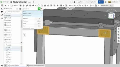

On this topic, PTC have just rolled out this functionality in Onshape.
What's New 1.157 - Frame End Caps
