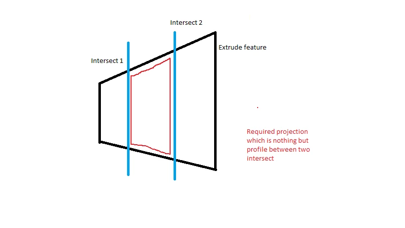

Thanks for your extended hand of support. I do understand that this is not best practice as it makes difficult to understand, but we are trying to achieve different things through toolkit code and for that, I am trying to understand manual feature creation as I am not much aware about core designing.
Thanks for this part. Additionally what we need is to identify profile between two intersect feature. Please find attached file for detailed understanding of what is required to project. The entities in red (profile between two intersect) need to be identified by projection.
Thanks a lot again for your all helps and time.

2-Explorer
August 30, 2019
Is there a way to do achieve the same?
Feel free to ask for any query.
