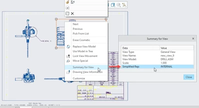

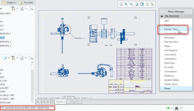

Dec 6, 2021 6:20 PM UTC
To determine the source model for views and repeat regions:
  • View
    • Layout tab > Select the view > Right Click > Summary for View > Note the value of Simplified Rep

  • Repeat Region
    • Table tab > Repeat Region button > Model / Rep > Select the region > Note the message area indicates which model and rep are used
