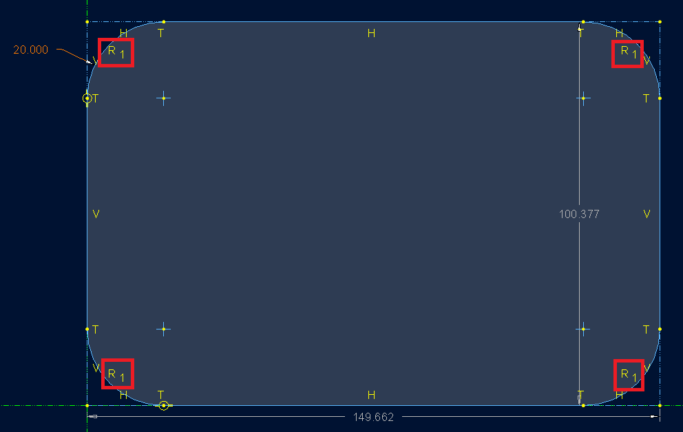

like d230 = R1
d232 = R1
d233 = R1
but instead of writing it like that (and having less readable code) i would like to write it something like:
d230 = d232 = d233 = R1 or
d230, d232, d233 = R1
I know that you can press control and select all the lines (for fillet in this case), but i would like to call them all from the model on the drawing (because if i manually dimension it, the dims sometimes lose the connection and go purple, when i change those or other values).
I also have pro/program available, if it helps.
thanks.

you have bad luck . Requested notation is not implemented.

as Ben Loosli indicated, inside feature (Extrude, Revolve) section you can set fillet radii equality using sketcher Equal constraints. In such case all radii are driven by one dimension and therefore you need to define one relation, only.

Set the radii in your model to be equal, then you only need to set d230 = R1.
Better still, select properties from your first radius and rename it to RADIUS1, then set the other radii equal to that one.
If they are in multiple sketches/features and cannot be set equal, then let the system build the relations by editing the values and entering RADIUS1 for the dimension.
