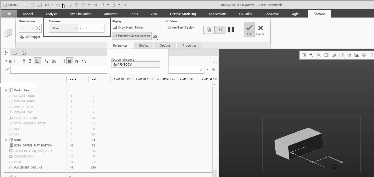

Is it possible to control the increment when using 3D Dragger to drag the section
Is it possible to control the increment when using 3D Dragger to drag the section during creating Cross Section or to have a toggle in offset value area to increase or decrease the value for example by 0.5 or 1.

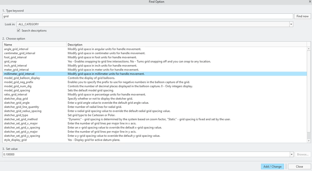

I believe modifying one of these config.pro options with the suffix"_grid_interval" will work for you:
(I only tested the option highlighted as we use mm units in our models)

Rajput5-Regular MemberAuthor
May 13, 2025 4:28 AM UTC
Hello Pausob,
Thank you for your input, it worked as per my requirement. Appreciate your your input on this.
