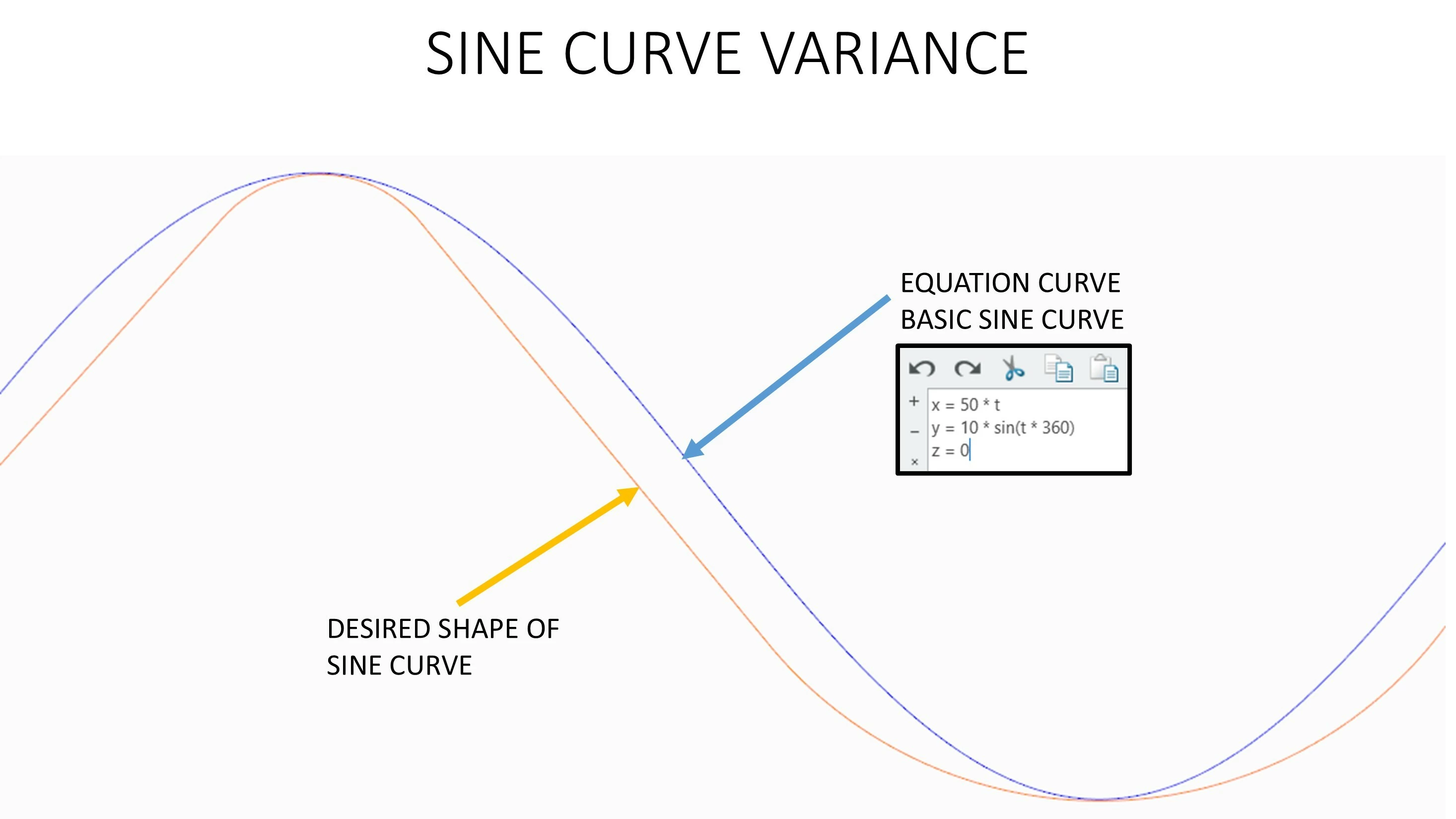

I have extensively used equation curves based on the sine curve formula in the work I do.  I would like to be able to vary this to where the upswing of each wave is tighter than the downswing.  The wave itself would retain the same height on the upswing and downswing only the radius values would change.
Below is a mock up of what I am hoping to be able to do.  Also, I would like to be able to repeat this pattern.  I am hoping that this would be possible.

    You might be having trouble because of the nomenclature.
    The x and z components of the equations driving your curve will remain the same.
    The calculation of the y component in the adjusted sine wave will be what you apply the modulated curve to. Also, for equations defined in Creo, the angles provided to trigonometric functions are in degrees, so multiplying by “2 pi” is incorrect. The “0.3” term in the equation is in rad, but again Creo deals in degrees, so 0.3 should be about 17.18.
    The equations I put in to define an adjusted sine wave are:
    x = 50 * t
    y = 10 * sin ( 360 * t - 17.18 * cos ( 360 * t ) )
    z = 0
    You can adjust the “17.18” to change the shape of the curve to your liking.

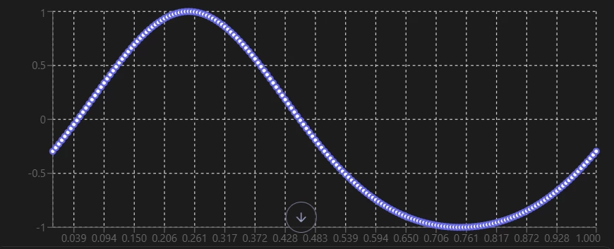

    Assume that we are in the time domain. You have to develop an equation that varies the frequency as a function of time over a single period. Assume the period is 1 second (freq of 1 Hz). You can generate such a wave form from equation.
    The equation used to generate this waveform shown below is:
    x(t) = sin( 2πt − 0.3·cos(2πt) )
    Plot is a function of time from 0-1 second on X-axis with Amplitude on Y-axis
    Derived quantities for this plot:
    • Phase modulation index: β = m·f₀/f_m = −0.3 rad
    • Instantaneous frequency: f(t) = f₀(1 + m·cos(2πf_m t)) → swings 0.70 Hz at t = 0 to 1.30 Hz at t = 0.5 s
    • Window: t ∈ [0, 1] s — one period of f_m
    General form of the equation:
    x(t) = A · sin( 2πf₀t + (m·f₀/f_m)·cos(2πf_m t) )

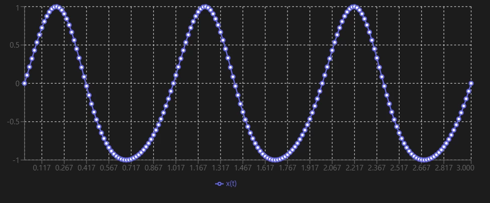

    By introducing a phase shift the amplitude will be zero at t=0. Here is the function plot over 3 seconds with the phase shift introduced.
    x(t) = sin( 2πt − 0.3·cos(2πt) + 0.3 ),   t ∈ [0, 3] s

    Ken:  This absolutely is what I was hoping for!  Yes, understanding how to convert from different units can be a hurdle.
    I appreciate your answer which I could verify and I appreciate everyone’s help in pointing in the right direction.

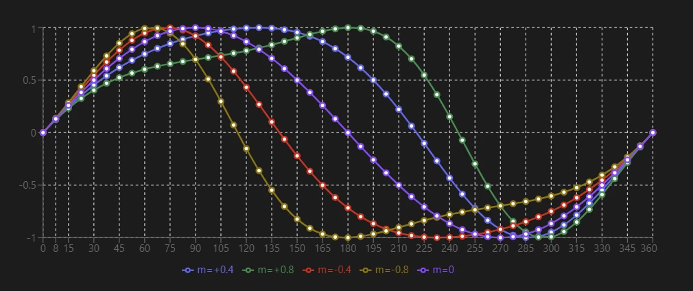

    I would ask what are you using this equation driven curve for? The context may be important because if you explore the nature of the general form of the equation I initially presented it might matter. Note how the waveform will change based on parameter “m” noted above. This might mean it is not the best or even a good equation for your intended use.
    Comparison plot for values of “m” parameter
    m=0 is a pure sine wave

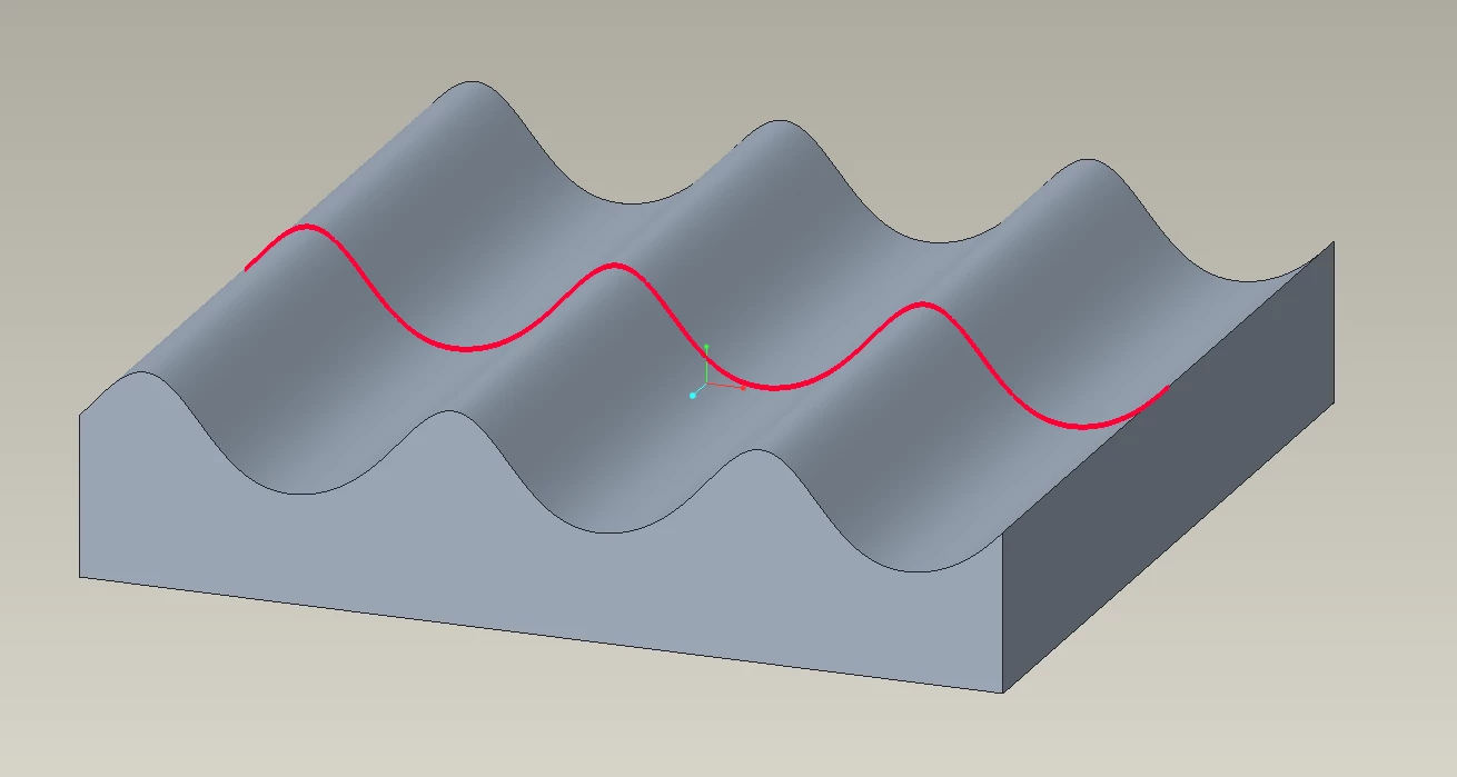

    Tbraxton:  In this case the form can be fairly loose.  The application for the scallops is for grip on tooling which has worked fairly well.  I am envisioning that a tighter pattern might even be better than what I presently am using.  Since the tooling is fairly large, I am hoping to not give our machine shop more work by decreasing what would be the fillets on the tooling.  To be able to have the corner and fillet values tied together and yet separate in size will be very helpful.

    If I am picturing this correctly, you are using it to “maximize” the radius at the trough of a cut taken out of material with a cutter. It will be something like this cut taken from the block? I am not sure what “controls” you want to use to drive the geometry in Creo, but it should not cause an issue with tool-path generation as it is a continuous function over a range of values that should be suitable.
    Modulated sine wave cut topology to expand trough
    pimm15-MoonstoneAuthor
    Oct 13, 2026 7:14 PM UTC
    Yes; that would be very close to how the application looks that I would be using this for.  I have just projected the sine curve to a sketch and have extruded the sketch to apply to the tooling.  This certainly beats using a repeated pattern.
