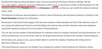

Aug 6, 2024 11:31 AM UTC
I am on Creo 9.x.x.x
While rummaging through the help files I came across this page. Hope this helps. I must admit that I have not tried it since the number of decimal places are set to 3 in my case.
https://support.ptc.com/help/creo/creo_pma/r9.0/usascii/index.html#page/detail/About_Setting_Decimal_Places_for_Dim_Tol_Values.html#
