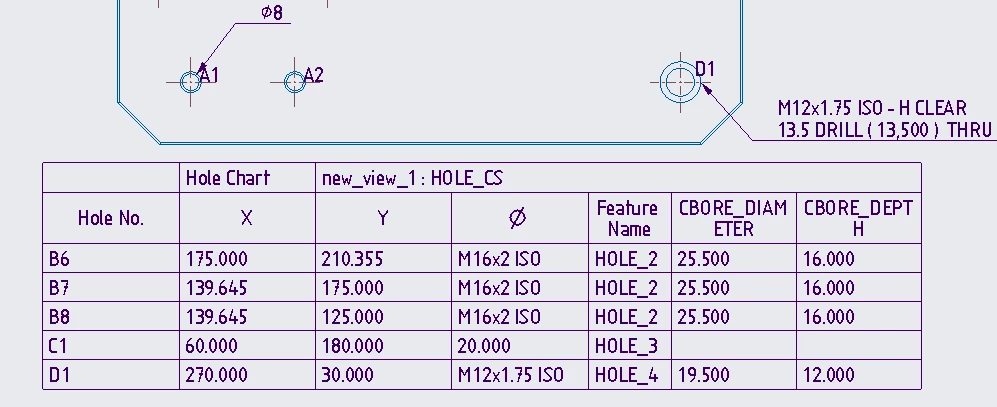

Is it possible to show the hole note as a column in the hole table instead of just the diameter?
    Sep 29, 2026 10:56 AM UTC
    One can get something like this.
    I prefer to state the note directly on the feature instead of a hole table. I do not use Hole Table at all.

    HI ​@club_75
    There is no option to get it as expected in Creo Parametric.
