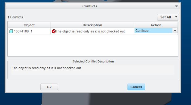

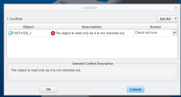

Is there a setting to set the default action to Continue when editing a part?
We would like to user to have there Action option be set to Continue instead of Check out now.
2-Explorer
December 22, 2015
Option is:
dm_checkout_on_the_fly
checkout is default value
continue is other allowed value
