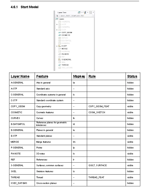

You don't want to be creating layer rules all the time.  This is something you set up in your templates and then they just do their job for you.  I have a set of rule based layers that allow everything "hidable' to be hidden even when the global datum toggles on.  I can then use my layers to show only what I want to see.  I can also create other new layers with groups of items to make them all visible at once.

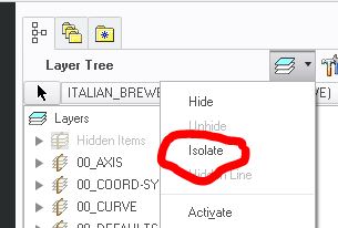

On your original question, if you have the datum features on their master layers and hidden, you can then put individual datum features on an additional layer to control them independently.  You would then use the isolate command to force that layer to be visible.  Maddeningly, the isolate command is only available in the drop down menu in the layer tree:
Again, it's more complex than it needs to be, but it works well once you've mastered it.
I've attached a PDF that I created some time ago that explains how we use rule based layers here which may be of help to you.  There's also an old blog post here:

It will be hard from your current perspective/position because of legacy, but once set up, it becomes automatic.
The simplest way is to select and hide.
The smartest way is to use rules.
I think the attachments will answer the questions regarding simple operations and hiding by default.
I too am in the midst of a change like you an have been implementing these fundamentals.
I have attached some examples of what has been done.  Everyone working with it at first cried about it because it was not how they did things which was mostly OOTB.

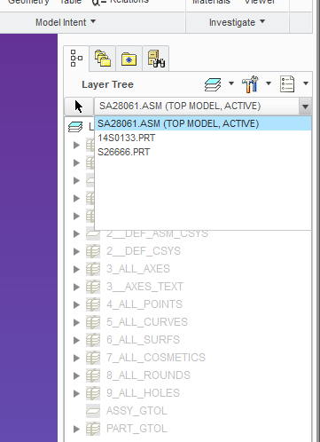

With layers in use, if you only want to see items from a specific part or assembly, select that file from the drop down at the top of the layer tree to isolate the layers for that object.  You can then unhide the layers for that object.

  1. I first select the "assembly item", for example a coord system. Most likely I can use the Model Tree.
  2. Then I switch to the Layer Tree
  3. In the dropdown I select the component I am placing
  4. Then I "browse" to the coord system to select the "component item"
Voila, without even showing and hiding any layers I have placed/constrained my component. (who needs those stinky layers anyway ;-))

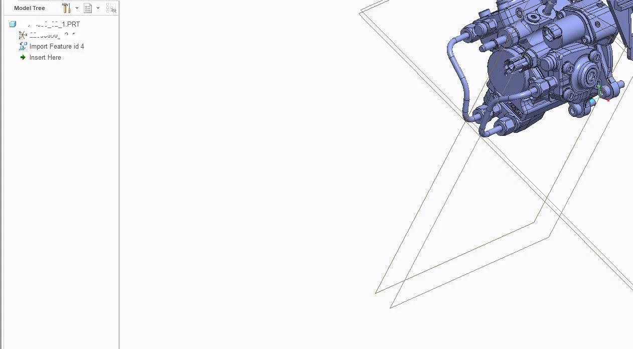

Dear Sir,
I had opened one .step file to a assembly file.
In a Assembly there are two plane, which I want to hide or delete it. I can select those planes but I am enable to hide or delete it. Can you guide me in this subject.
