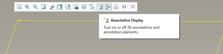

You can toggle annotation display on/off in part mode using the GUI:
Are you using a combination state(s)?
Review this link and let us know if simply toggling the display does not solve the issue for you.
About Working with Annotation Features (ptc.com)
