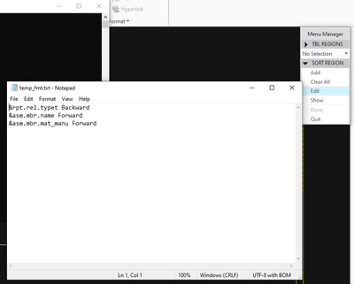

You can sort repeat regions. Check out this link:
https://support.ptc.com/help/creo/creo_pma/r9.0/usascii/index.html#page/detail/To_Add_a_Sorting_Parameter_to_a_Region.html

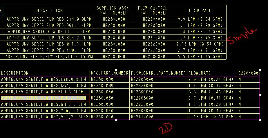

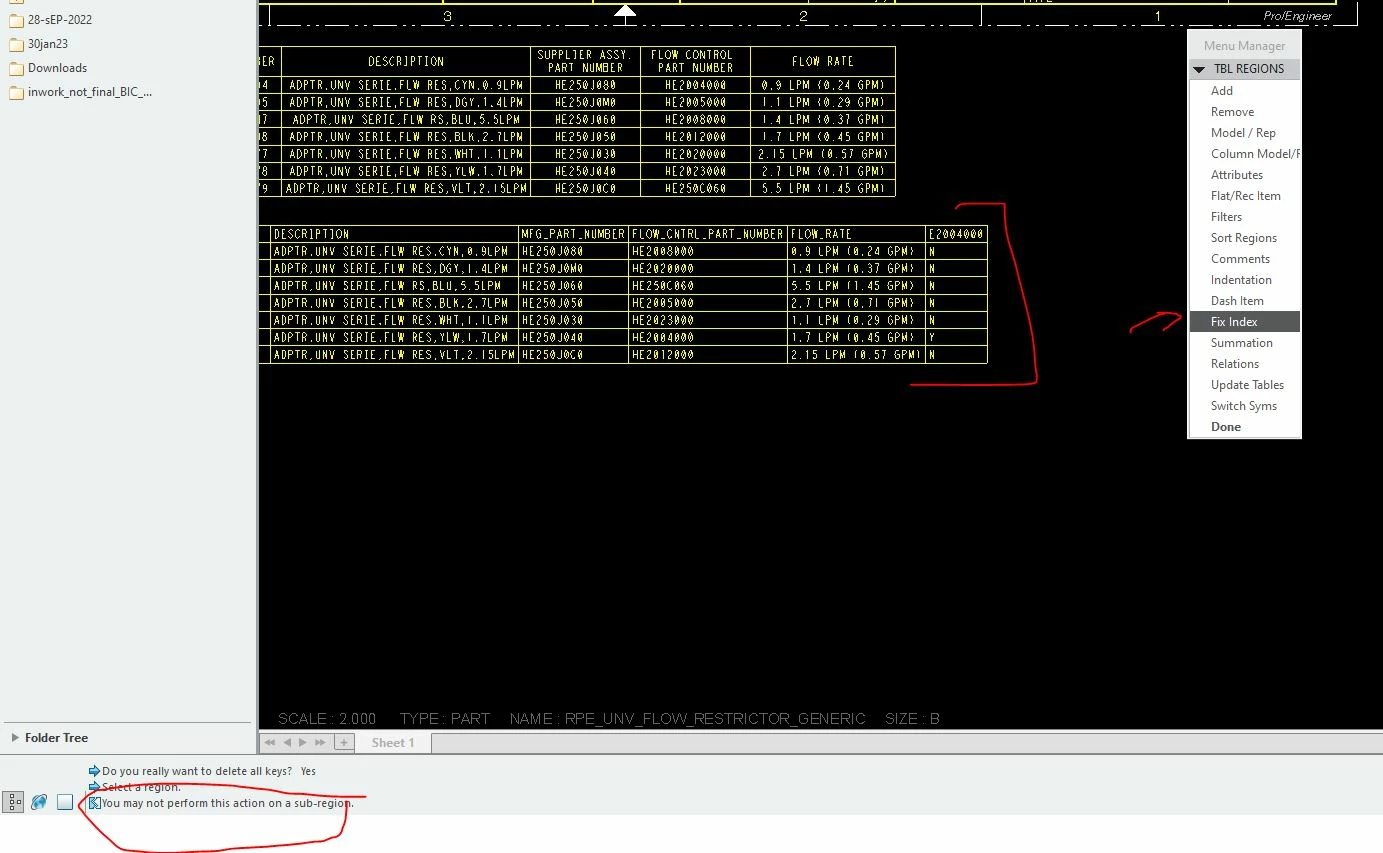

I want to sort the entire table row based on the flow rate -refer the attached image.
I have created table by 2D repeat region option and Simple  repeat region option. but im not able to use fix index or sort option to simple repeat region table.
and for 2D repeat region, sorting is happening individual column wise - sorting is not happening for the entire row.

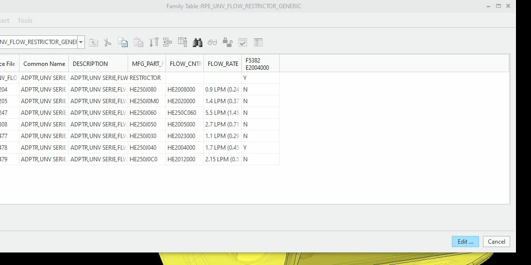

so ... you want to display the contents of family table in drawing in specific way.
I would say you cannot use this solution because the table contains several independent repeat regions. If you sort one of them the others remains intact.
2D repeat region
I would say Sort command enables you to sort columns, only.
You can get requested solution only in case that you reorder instances in family table.
