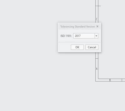

ISO standard in drawing
Hey, I want to set tolerancing standard version to ISO 2018 but only ISO 2012 and  2017 are available in options, is there any file which can be downloaded to get the ISO 2018 standard?

Standards are not usually revised annually, but ever 5-10 years.
Looking at iso.org on this page: ISO - ISO 1101:2017 - Geometrical product specifications (GPS) — Geometrical tolerancing — Tolerances of form, orientation, location and run-out
It says that the 2017 released standard was reviewed in 2022 and is the latest version.
